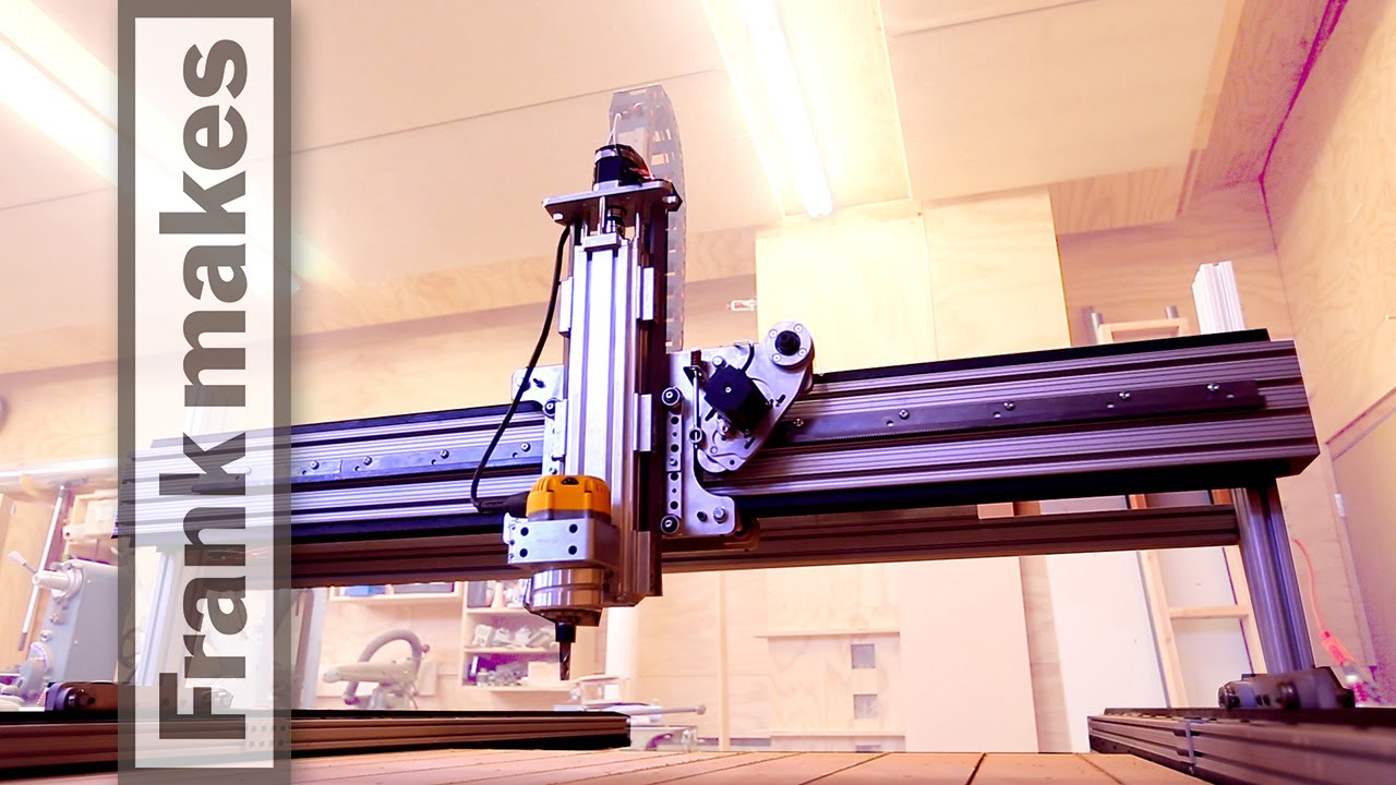

This is what Frank did for his CNC build. Start at about 7:10.
