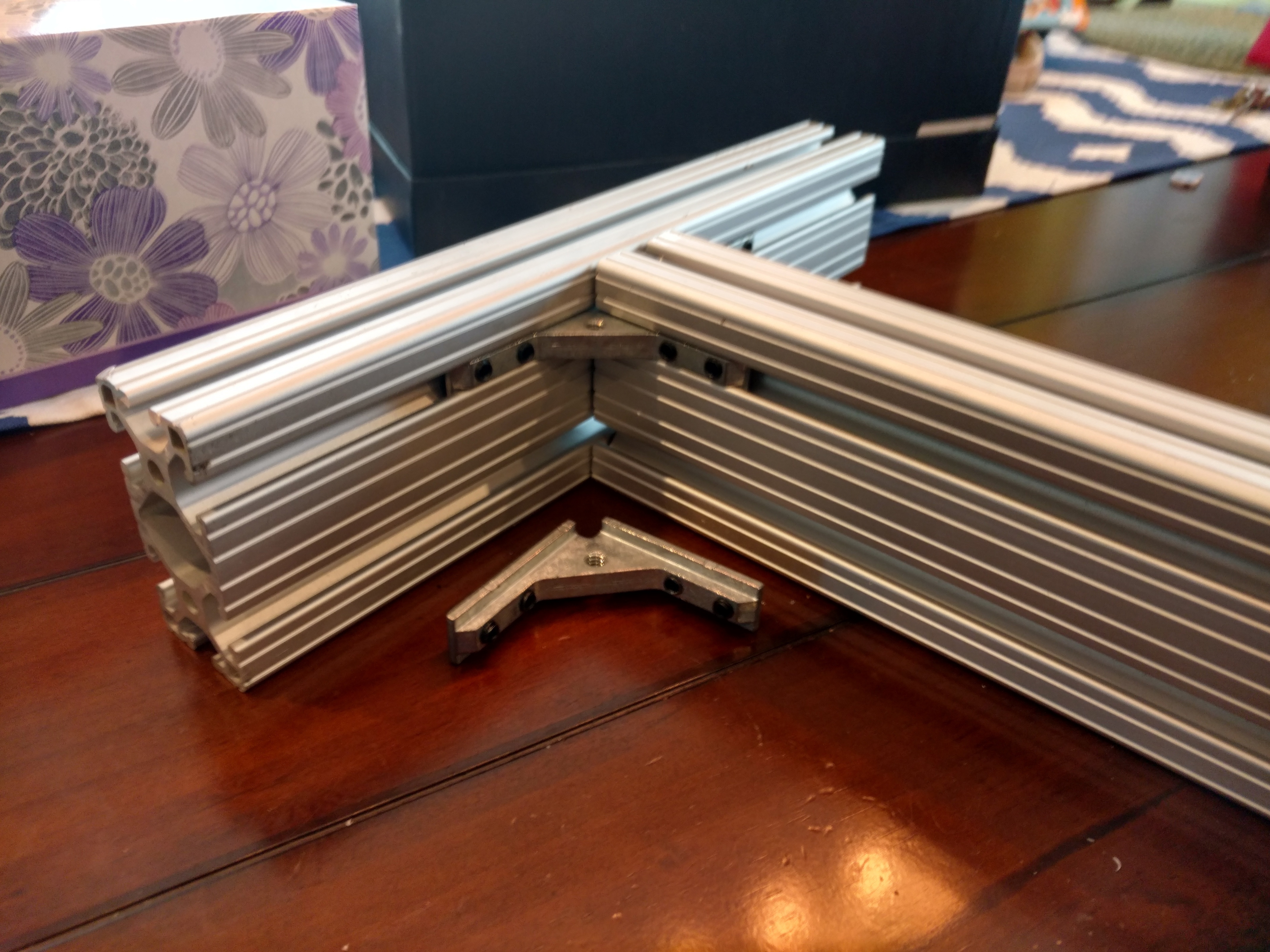

80/20 is my gold mine, you can find them in internal connectors category. The ones you see here are 15 series 1.5inch, Xcarve is using their 10 series I believe.
I wondered what that drill bit was for… too late!
