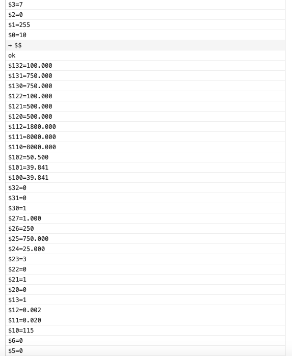

Alright, so I bought an x carve used, brought it home and set it up.
Calibrating the X and Y axis was pretty easy and so was the Z axis once I did it a few times. When I calibrated the Z axis the $102=50.5, so at that point everything to correct.
Using the Z probe, I go through the setup and as soon as I lift the Z probe to the bit to verify the connection, the $102 changes to $102=188.976. It has done this several times and it’s always this number.
I finish the Z probe setup, not knowing that the $102 has changed for some reason and the start the carve. The x carve goes to the X and Y Home and drives the bit all the way into the workpiece and into the waist board.
I’m at a loss at for what could be changing the settings during the job setup. I will say that I can manually set the Z height a paper thickness above the work piece and the carve is successful. Any help is greatly appreciated.

The machine setup? Don’t do that after you change settings.
What kind of Z axis do you have? 50.5 is an unusual value for an X-carve…I think.
Note that there are two areas where actual travel can be adjusted, outside the mechanical aspects of the macine:
  • Microstep settings (Done on the driver side, usually by confuring a set of dip switches)
  • GRBL parameter ($102 in this case for Z)
Machine Setup is a one-time deal, once set there is no need to revisit it again.
Fine-tuning is done by editing whatever GRBL parameter is involved.

Yes, the machine setup. I’m not sure how often I need to do it. Do I run the setup each time I log in to the x-crave or easel? Will it remember the settings from the last time I used it even after I shut off the computer?
I have a C4N Z Axis Lift (6 inch. version)
Don’t run the setup again. Just change the settings you need to change and never mess with it again. The GRBL settings are stored in the controller, not your computer.

I get to the GRBL settings through the Machine Inspector correct?
  • that’s how I corrected the Z axis calibration.
Yes.
Send $$ to see your settings.
This Carve was successful…but I kept checking to be sure that $102=50.5 (the calibrated z axis setting)
It’ll stay that way until you run the setup again or explicitly change it
