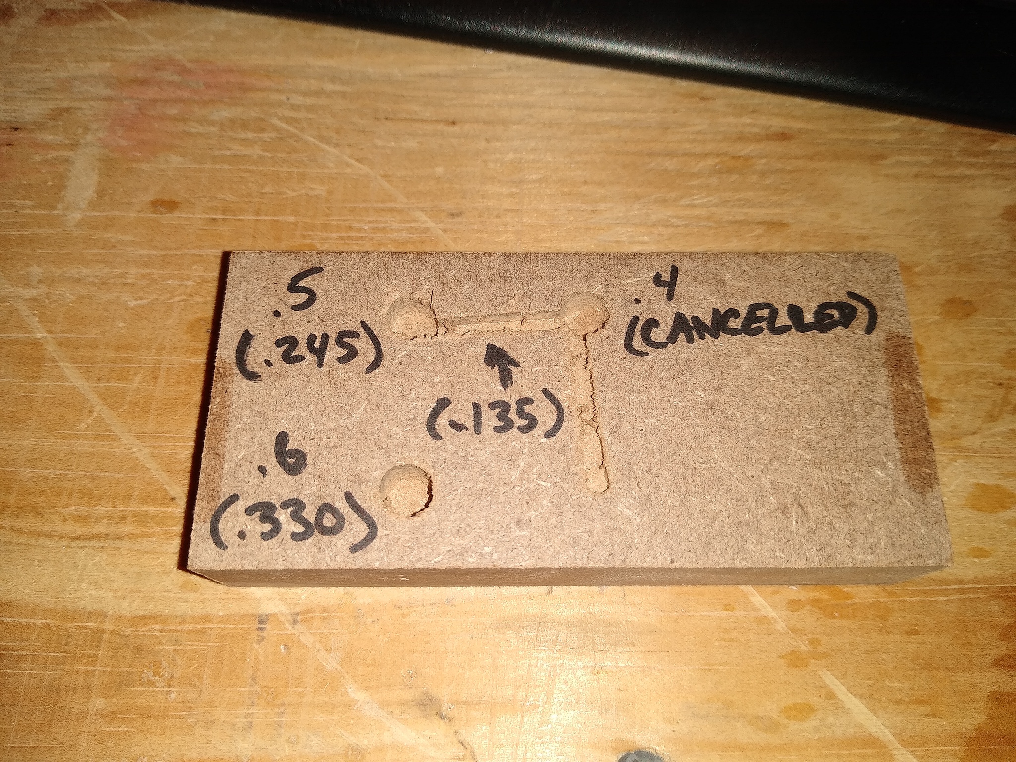

I just carved this test project:
Holes were designed at depths of .6, .5, .4, .3, .2, .1", with a depth of .060" per pass. What I got was .330", .245", a drag at a depth of .135" when I stopped the cut. The .600 (.330) hole made the first 2 passes were in the air missing the work piece. The .500 (.245) hole made 1 pass in air, then seemed to cut normally, except the Z-axis raised for 1 or 2 passes.

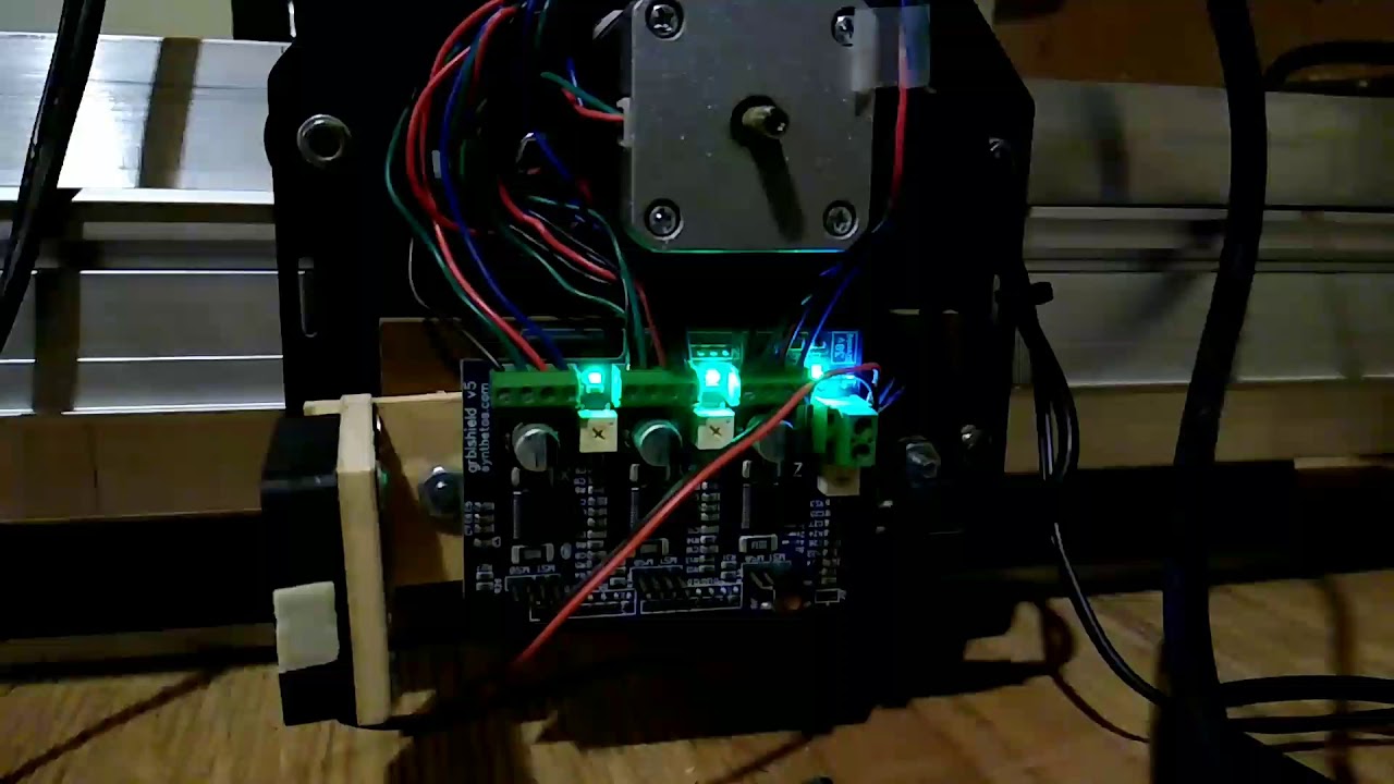

Edit: I just noticed that when my Z Axis moves, all 3 axis lights come on. I wonder if my gshield is suspect:
