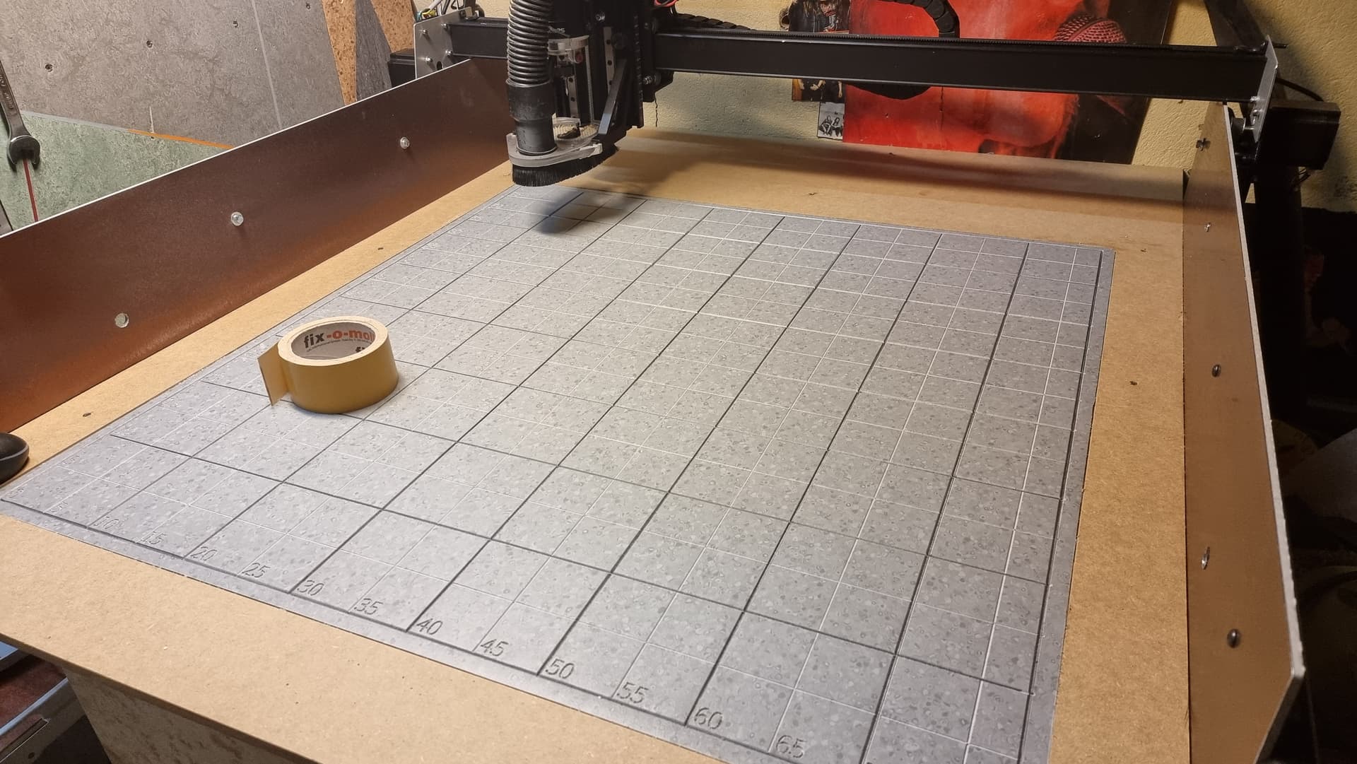

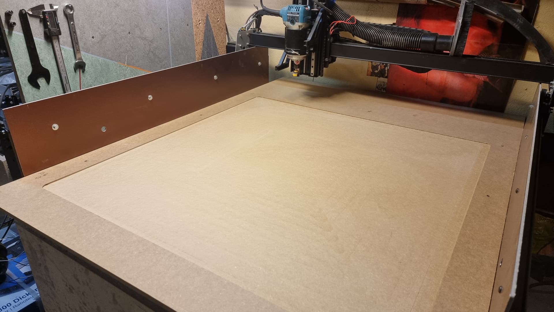

Was upgrading X-Carve and when I set Easel up for the update all the movements work fine, but when I try to carve then nothing happens and the computer drops out of Easel.
Does anyone know what the reason is.
