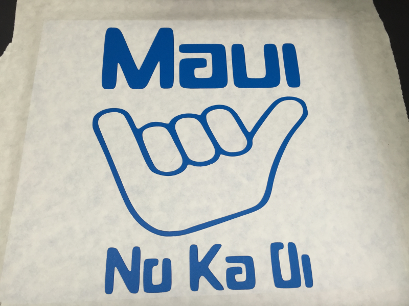

Here’s a picture of the finished cut. Even though I milled out a piece of PVC (that sits on top of the X-Carves waste board and underneath the self-healing cutting mat) so the entire surface would be a parallel plane to the plane of the spindle it appears I still have a low spot (see upper right corner in the photo). Still, the design was cut all the way through in the freezer paper.
Here’s what the stencil looks like once I’ve removed the cut areas:
It seems critical to have the spindle plane and the cutting surface plane be absolutely parallel to one another. I thought I’d taken care of that with my PVC milling work, but I guess not. The Cricut knife (Amazon.com: Cricut Deep-Point Blade + Housing, Cutting Blade with Deep Cut Housing, Cut Materials up to 1.5mm Thickness, For Personalized Crafts, Compatible With Cricut Maker and Explore Machines,Black) is spring-loaded in its housing which, I think, will help alleviate this problem. However, if you look closely at the shape of the housing it’s more complex than the Cameo’s and will take some serious Sketchup work to design a holder. I’m pretty much a beginner with Sketchup so if anyone has any tips I’d appreciate any guidance.

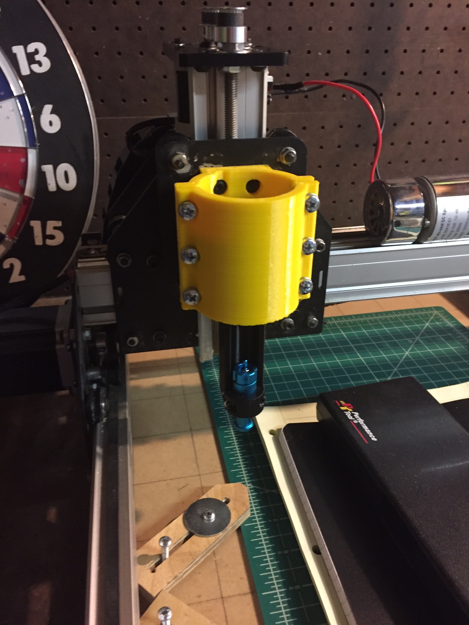

The simple Cricut knife adapter I made for my X-Carve worked nicely. In the picture below you’ll see the gold/brown adapter that’s simply a cylinder with an expansion slot. The inner diameter at the top and bottom ends are set to fit the spindle and knife housing, respectively. It’s a tight fit and it holds the knife housing secure enough to make the cuts. I used a Dremel on the cap of the housing since it was just slightly wider than the rest of the housing. This assembly works much better than my original knife idea. The spring-loaded knife is a benefit. The only letter that caused a problem was the ‘w’. The sharp turns are a challenge for this approach. I cut at 500 mm/min to a depth of 0.6mm with 0.2mm increments. That meant the knife went over each outline 3 times. I think that’s overkill and will, in the future, set it to only cut each outline twice. When the knife only cuts an outline once there’s often a small gap between where the knife started and where it ended. The double-cutting eliminates that. The stencil was cut in freezer paper held down to the cutting mat with a very light application of Krylon’s Easy Tack.

The Cricut blade/holder is definitely the way to go. I printed out a bracket to hold the blade housing.
I also tried cutting on the cutting mat that goes with the Cricut. Surprisingly, that mat didn’t work as well as the generic mat I had been using. After a few more trial cuts I finally decided that having the cutting plane parallel to the waste board is important so I printed out a bracket to hold a AccuRemote digital depth gauge.
I used the gauge to determine the slope of X-Carve’s waste board surface and place spacers underneath to make it more parallel. It’s not perfect, but now there’s no more than 0.2mm between the highest and lowest points.
The top photo shows the end result of a cut using freezer paper. I cut to 0.3mm with 0.2mm increments so the blade went over all cuts twice. The cuts are much more uniform over the entire surface after the leveling exercise. A few of the letters are raised, but there were no tears as in previous attempts.
