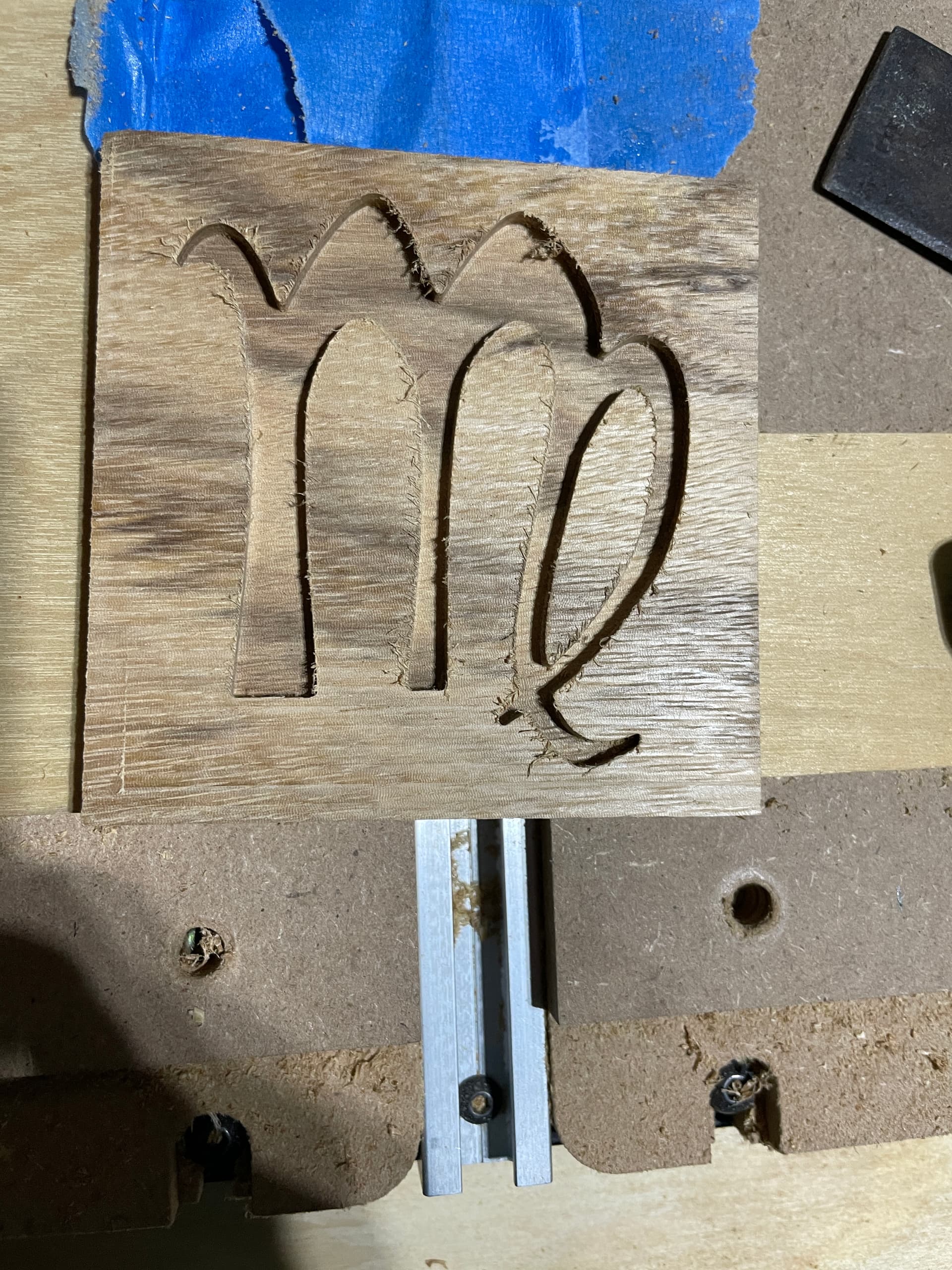

Im also having a similar issue with my new x-carve. Im trying to cut pieces out for a drawer using the box maker app from design.
Its odd that the first 2 carves goes great, right on the expected path but then when the Z drops the 3rd time to cuz deeper it thows the X-Axis carving off.
I’ve checked tension on belts,
No odd sounds are made.
Machine seems pretty square and parrallel.
Im wondering if its a power issue but I dont know how to check that.
What are you cut settings?
Check eccentric nut adjustments too!
Thanks for the quick response @SethCNC!
Cut Settings:
1/8" single flute end mill
Feed Rate: 72in/min
Plunge Rate: 24in/min
Depth per Pass: .1in
Fill Method: Offset
Plunge: 20°
- I did go back through and tightened the belts as they were a little looser than recommended in the maintenance section of the build.
- Also noticed the V-wheels on the eccentric nuts were spun freely so those have been adjusted so the wheels still spin but not easily.
- Upon other research I’ve seen where others have used a block of sorts to pull both Y’s to the front to make sure they are the same. So I put one of the spare bolts and spacers on the Y2 axes to help make sure they stay aligned with each other. (when machine is off and in home position, i move both Y1 and Y2 to the front which are both 1/2 Inch from the front.)
- Since doing those few things I ran a small 4"x 4"x 1/16" surface job that seemed pretty spot on.
- I’ll try something bigger in the next couple of days and report back!
- On the cut above I shared a picture of it appeared that the cut only went off path after it dug into the material - maybe the 20° is too aggressive?

Just to follow up, I was able to get a bigger cutout. I ended up redesigning it anyway. Regardless, it came out just as expected, and the router stayed on path so hopefully others will find this useful. Thanks @SethCNC!
