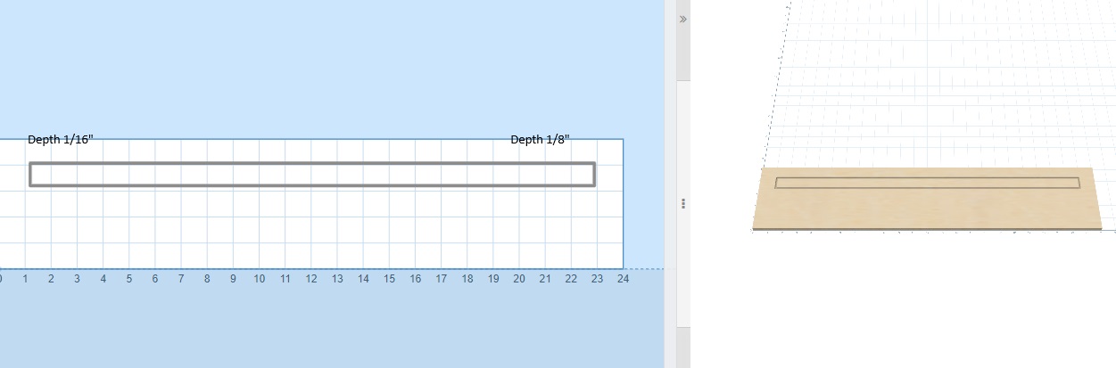

Help! Using x-carve and there is an issue with the x axis cut depth. Over an approximately 22 inch cut there is a difference in cut depth of 1/16 of an inch. Been racking my brain on how to adjust the cross bar to compensate but having no luck figuring out how to adjust it.
Have you trammed the table in relation to the axes? Have you leveled the bed?
2 Ways to Tram Your CNC & Quick and Dirty Bed Leveling (youtube.com)
I will watch the video link and give that a try. I did some of the things in the maintenance and troubleshooting. I am beginning to think it is the wasteboards, love mdf and the way it reacts to weather. I’ll let you know what happens with the tramming.
