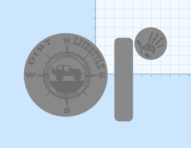

So in my ongoing effort on this project, it is a flat surface much like a cutting board but it has three different “cut outs” that are 3/16" deep, in the bottom of those cut outs is art work, some sort of routed out design. I am having problems with keeping the art work centered in the cut outs. I make a complete work piece with the cut outs and the art work, then I duplicate that and take out the art work for just the cut outs, then I make another work piece and remove the cut outs and leave just the art work. The problem arises when the piece is done, the art work may or may not be positioned correctly…what am I doing wrong here?

Is this misalignment happening in your design or in the actual carved piece?
If in the carved piece, are you joining between operations? Changing bits?

there is a bit change between the “pocket” phase or work piece and the “artwork” phase of the work piece. The machine is zeroed to the center of the blank before beginning and returned to “zero” after bit change just to ensure that everything is still aligned/zeroed. but 3 out of the last 7 jobs the art work as been misaligned…
In the actual carved piece.
