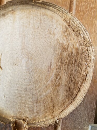

it worked fine on the test carve, now it has starting moving to the left. where should I start looking first.
1000 mm xcarve, dewalt 611, 1/4 2 flute up bit,
I will check the belts tomorrow, as far as the potentiometers I an running the x controller probably not that.
In the photo it looks like the carve is deeper on one side?
Check to make sure your spindle and bit are square to the work surface.
Do you have the 1000? If so you will really need to do one of the stiffing mods.
Yes I have the 1000, done all the stiffing mods. Everything worked fine until last night, The carve moved to left every time it would start at a new depth,
That sounds like something shipping / missed steps.
Check your pulley set screws.
Then belts and V wheels.
You may need to bump your motor current, but my bet is the pulley.
well I checked all the belts, pulleys, v wheels and couldnt find anything off. Then I checked the y axis it was off by a little more than a1/4 inch. It is amazing the amount that one side can be off from the other just by bumping it. I hope this fixes it.
Well this is baffling, it steps to the left every second depth drop until the last 9 mm it cuts fine.

That is very odd, it almost sounds like a software issue.
Try air cutting and see if it does it?
You can best eliminate the idea of a software problem, by looking at the G-Code. Generate the G-Code (follow the âAdvancedâ link, under the Machine tab), open it in a text editor (such as MS Word, Notebook, etc.) and look for your Z moves, using your text editorâs âFindâ tool. It should be relatively easy to identify the Z axis move that begins each circle. The X and Y values after each Z should be identical to the previous layer.

Are the âstepsâ only on one side of the hole? Check that your spindle/bit is square to the surface. Iâm suspicious that it is tilted, so that the bottom of the bit points into that wall. For the bottom 9mm, the upper portion of the bit begins to act like a pattern bearing.
yes the steps are one side and I checked the z for square and it was good with no play. Well i went through and found all the Z- this is what i see

It took a bit of digging in excel, to sort out exactly what is happening, but the G-code is calling for identical coordinates at each of the four âpoints of the compassâ. There is no âstepâ in the code.
I looked at the Min X, Max X, Min Y, Max Y coordinates at the top and bottom layers and they were identical. Hereâs a sampling from the left and right of the diagram above (each column is a different Z, at the top, mid and bottom of the cut).
Well thanks for looking, I will keep trying to figure this out. I used the calibration test from @RobertA_Rieke last night and it worked fine. I cant figure why it would step on the first half and be fine on the second half. I checked all the belts, pulleys and checked for square, just cant find it.

I wonder if the âslotâ in the piece is causing the bit to âovershootâ, as it encounters less resistance. Are you cutting CCW around that pocket? Does the stepping stop, with the first cut deeper than that slot at the 6 oâclock position? You might try cutting clockwise and see if the steps go away. Or, if youâre cutting that slot, change your order of operations and cut it after the circular channel.
I am having the same problem, but my carving moves up (the y-axis) on most passes. Some times 1 or 2 mm, and once about 5 mm. Once this started happening, it has done it on the last 3 projects that I have tried. Very aggravating.
Mine seems to have been fixed, I am not sure what fixed it. I did a lot of tweak and checking and tightening.
