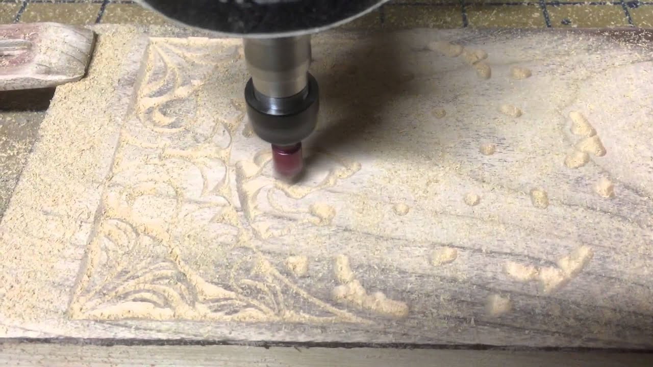

I started the job and it took about 35 minutes and looks better than anything I have done so far on the machine.
Here is the finished piece, it needs some sanding and clean up but I think it turned out really nicely
I now understand the discussion in another thread about how difficult it can be to clean up a carved piece like this. Lots and lots of tiny grooves that need sanding.
Here is the 3D view of the piece in Vcarve
Here is a short video of it being cut. I am so impressed with how quickly this is done with a Vbit.
