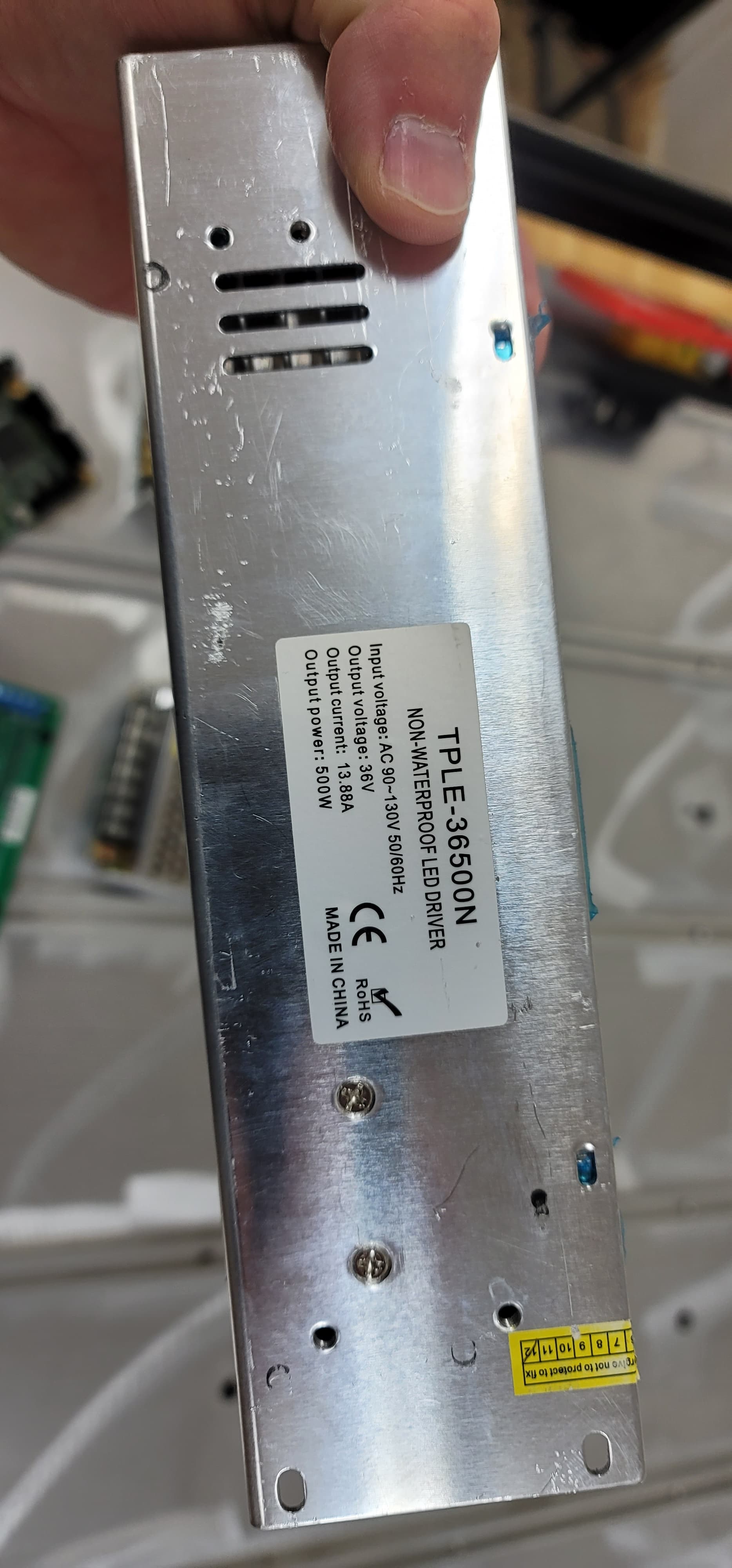

The power supplies are most likely for the steppers. Where the specs on the PSUs?

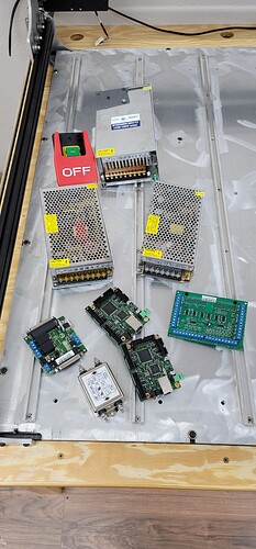

These are all of the electronics he gave me.

Those (the two that are the same) look like Ethernet CNC controllers… Definitely not Grbl. Maybe Mach 3/4?
I think your 3 power supplies are 5v for the controller, 24v for a spindle ( did you get that too? Looks like some sort of pwm controller for that maybe) and 36v for the steppers.
None of this is standard Xcarve.

Ethernet SmoothStepper apparently
With a VFD?
Well that’ll be the source for connecting things.
What’s the green board with the screw terminals?
Yes with a VFD. Forgot to picture that
Finally found Smooth Stepper terminal board
That makes things easier. Are you planning on using Mach3 or Mach4?
