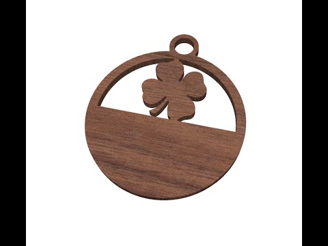

Hi all,
I am wondering how I would show a potential customer what the design could look like from Easel in a way that they would be able to pull it up in their email and look at it?

Screen shot the 3d view
If your using windows just hit the windows key and type “snip” and you can snip just a section of the screen…
With a few tricks you can add layers and change carve depths to even remove all of the waste and get a good reversing like this…
Thank you so very much!!
I actually recorded this to help someone else in a different group just a bit ago and at the end (you can just skip to the last like 1 min of the clip) I show how to get the part floating there without the outside section, in case you wanted to see exactly how I do it ![]()
