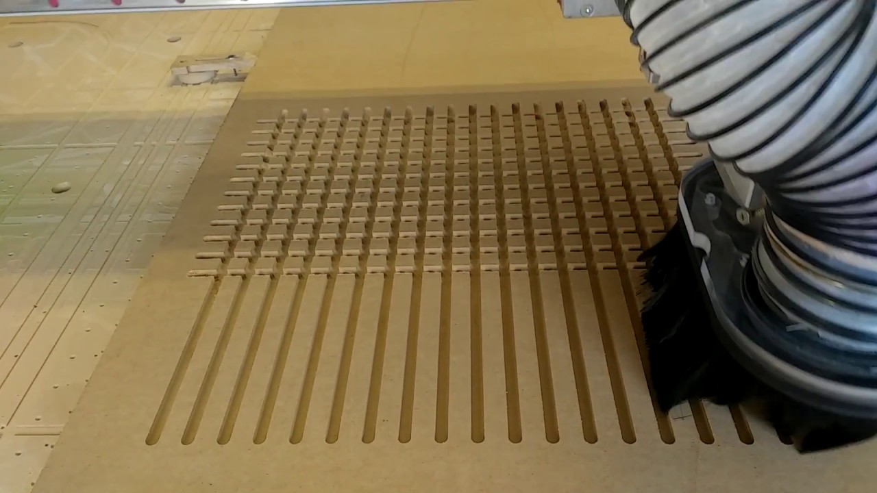

Alright everyone so I want to catalog my attemp at building a vacuum table for my larger machine (4x8) but the same concepts will apply if you want to make one for your x-carve
I am going to start out by making a small test piece and use that as a proof of concept
here is my progress so far
next step is to apply glue and water mixture to seal everything

so basically here is the design that I am following

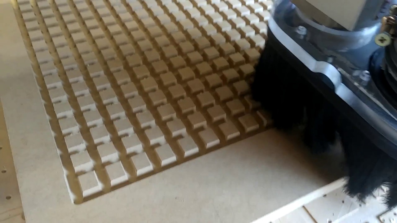

you will have a lower base board mine will be a solid piece just to hold pvc inlet pipe and give the plenum a ridgid mounting surface
then I will have the plenum as pictured above that contains all the vacuum channels
then on top of that I will have a bleeder board glued to the top of the plenum and this will have about .100" skim off the top and bottom and your material will get sucked down through it because the mdf is actually really pour us
and carve away!
How stiff will it be? Do you expect the wasteboard to flex when the suction is on?
the bleeder board flexing?
It should not flex at all as its going to be glued to the plenum in this set-up so basically you will have 3 pieces of 3/4" mdf glued together and so it should be extremely rigid
if I was going to use a gasket design then yes the bleeder or spoil board would flex but you want it to flex and make a good seal around the gasket but for this I dont think I want to use a gasket as I will just skim it completely of if I need to replace the bleeder board for some reason
