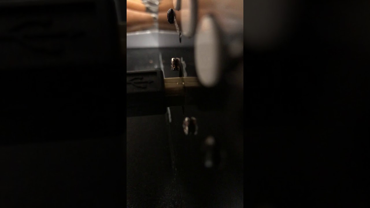

Hello all just wondering if anyone had tips or a product that could help stiffen or hold this usb B in place so it doesnt wiggle as much when its running and make easel think the projects done when its not.everynow and then it will interrupt my runs wish it was a normal usb kinda poor placement in my opinion thanks.
It is a “normal” USB. Are you sure that you tightened the bulkhead flush against the front plate? It looks like there’s a gap between the front bulkhead and the connector.
Mine inserts fully and I believe it has a little bit of a “click” to secure it.
Right i ment like a usb A…i will give this a try thanks
I tried unplugging it an plugging it back in an putting a little more force but i didnr hear any clicking noise an there is still a little bit of play
Had similar problems with random disconnects during a carve, tried every suggestion and still had problems. Found that replacing the USB socket panel connector with my own seemed to fix it for good. I had a 8" mini usb to full size and swapped it out. Doesn’t stick out so far and it works,so I’m good with that…

Ya myn defenitly does not connect like that or make that noise more like a thud but snug
I remember when assembling that the bulkhead took quite a bit of screwing to get flush on the inside of the box.

Inventables had a problem with the small internal usb cable that goes from the bulkhead to the circuit board inside the controller, sorted now. However, I took my internal cable out and connected the long cable direct to the circuit board inside, passing the cable through the usb b hole left vacant in the bulkhead. Never had a disconnect since.
