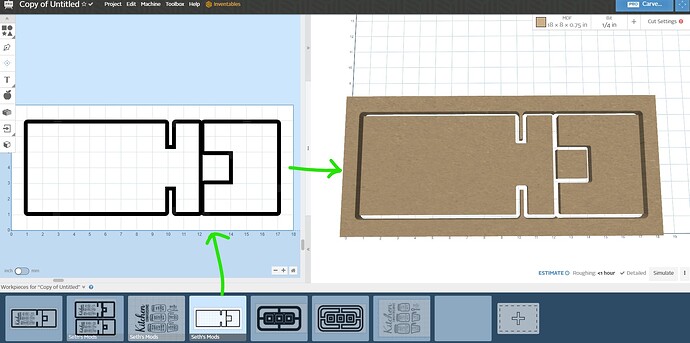

Ok, so the issue is that the design is inverted and because of that you had to set it to “outside the path” and then set a depth, well when a Vbit is used for “outside the path” and the depth is too deep that the vbit cannot go that deep within the width constraint of the design, then no toolpath is generated for that area.
Here’s the Fix:
Using some tricks i’ve learned over the years to separate the design we can create 2 separate selectable design elements. Then set the Engraving part as a “…pocket” cut type and the Perimeter as “outside the path” ; like this top one after and the bottom is the before i separated the parts…:
I assume you want to cut the perimeter using the endmill, but Easel doesn’t allow this when using a 2 bit carve, the Vbit will be used to cut the perimeter UNLESS you use the workpieces to separate the carve even further.
And this is where I will make one Workpiece (the bottom panel) setup for the Vbit engraving portion only, like this:
and the 2nd workpiece for the perimeter cut using the endmill like this:
And using this multiple workpiece method is how I’m able to control which bit is used in specific sections of different projects… here’s a video showing this concept in a bit more complex project since it also incorporates a pocket cut for the tray as well…
Here is the copy of your project with the edits I explained above under the workpieces titled “Seth Mods”
