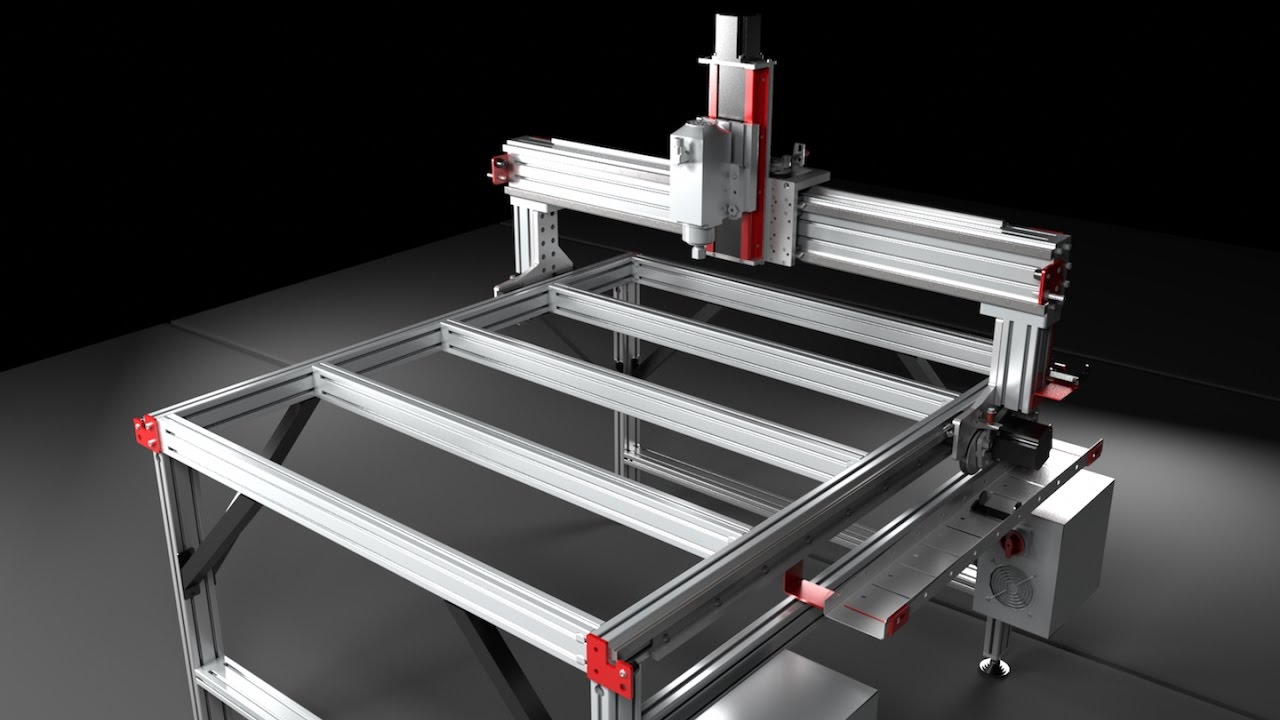

This is a great video on tramming put out by AvidCNC. I haven’t taken the shroud off of the XCP VFD to see if any adjustment is available but this is by far the simplest approach I’ve seen. You could probably even use the files from AvidCNC to run the gcode on the XCP. I’m going to try and run these test cuts sometime this week and see what my results are. I’ll report back. Below is the video link as well as the instructional link from AvidCNC. Hopefully the XCP has some type of adjustment if the results aren’t ideal.
