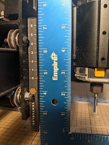

I bought a used X Carve 1000 fairly brand new, i used it a few times and find some depth variations around the spoil board.
I used a metal yard stick to check the diagonal and found that from corner to corner there the spoil board seems to me lower in the middle.
Now I used the longest steel carp square I have to take the same measurements, now this square isnt as long so it doesn’t go all the way to the corners, but does cover most of the center area of the spoil board.
Is this an illusion? Is my spoil board not the same thickness across the board? Is the support bar under the sb out of alignment just a bit somehow?
Next question,
I used the same steel square to check the Y rails to the spoil board and found that the right rail near line 20 is not square on the bottom part of the rail. As if its tilted inward.
Is this enough to have an effect on the cutting?
This same tilt is on the Z gantry on the right side but it is slight.
The left side of the board does not have these same gaps.
Now with the spindle at dead center of the sb, the spindle is perfectly square with the table
No light showing under the square on the sb
But, putting the square on the vacuum attachment bracket and there is a significant gap at the bottom, meaning the whole thing seems tilted forward. That same tilt found on the right side of the Z gantry.
I am tempted to disassemble and get things perfectly square but I dont want to chase my tail for something that doesnt matter if the spindle is square.
