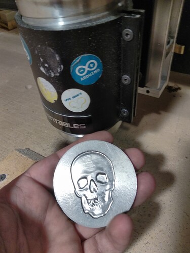

Did a small 2in 3d piece in titanium😁
`i can’t get it to post pics wth!
40ipm .02 rough
60ipm .01 finish
.1mm taper ball
Wow! I’m impressed! I’d think titanium would be too hard.
What endmill, HHS or Carbon?
Nice! Did you use any coolant?
I think the movie industry has led people to believe that Titanium is super strong and unbreakable…That door is made from solid titanium, you’ll never get through it! type thing
Well… they like to use it for armor in Thunderbolts.
But after a brief search it’s about as strong as iron, just lighter.
Which depending on application allow one to use more of it without the weight penalty of iron ![]()
Just a drop or 2 of some 3in1 oil
1mm tapered Carbide
