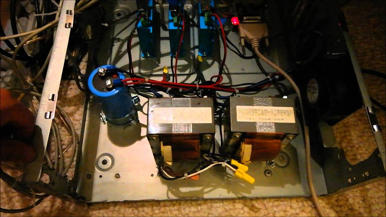

I upgraded my old MaxNC to optical encoded steppers and it was the biggest mistake.
I was never able to get the machine to run properly after that.
The problem being that sparks from the brushes in the spindle motor would cause single nose on the encoder lines causing a fault and staling the print. (Usually 23 hours into a 30 hour print.)
It took years of grounding, rewiring and adding filter capacitors to get it to even work. And even then it would still fail occasionally.
