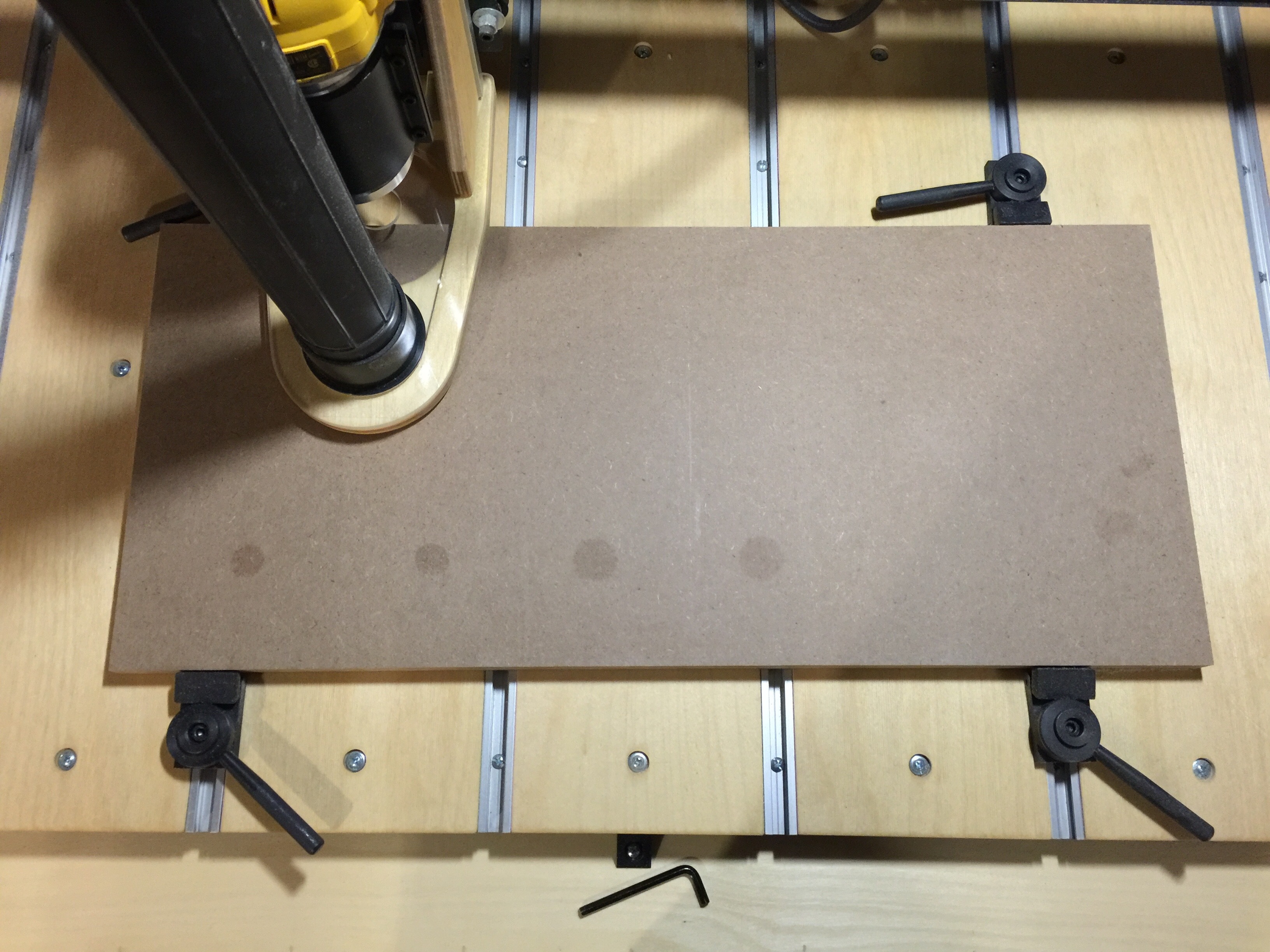

This T-Track bed is connected directly to the table top. I used 1/8 hardboard and 3/4 MDF cut to fit inside the maker rail, I did not use the center makerail support. I didn’t want a space under the bed, so I made solid to help keep it flat and quite. Then the T-Track and 1/2" baltic birch plywood slats to top everything off. I used long screws every 6" in the T-track to reach threw to the table top to sandwich everything together. The machine itself is also held down to the table top with 12 angled blocks.
You can see there is a small space between the top bed and the maker rail, but everything is secured to the table so not an issue. The baltic birch slats measure 5-1/2" wide, and 2-9/16" for the two side peices. The T-Track is .44" tall and .725" wide, and sits just below the baltic birch slats.
Got the T-Track on eBay: T-Tracks 4 ft. T-Slot, 48", Lot of 6, Aluminum, Clamping, Anodized, USA Made! | eBay
Got the Baltic Birch from Toledo Plywood
I ended up getting the shop fox clamps that inventables sells, but a word of warning on these clamps. All of them needed to be worked on to make them work. Fist off the rectangular peice that slides into the rails were oversized, they only needed the side ground down a slight amount to fit. Then due to inconsistant machining, two of the clamps needed to be drilled so that the Allen screw could sit down far enough for the clamp to fit in the T-Track. The clamps are rough, but after a little work they do function great.
Nick - I’m replicating your configuration w\ T-Tracks, it looks fantastic, can you tell me the spacing between the side and the first T-Track, as well as the spacing between each set of tracks…?
Also, if you had to do it over, would you stick with this configuration, or is there a change you’d recommend?
I wouldn’t change anything. I use a leveled waste board on top of the t-track bed, then double side stick my work peice to the waste board.
If you plan on carving your stock directly on the t-track bed (without a sacrificial waste board). Then You might think about 3/4" MDF slats (Instead of the Baltic birch slats I have) giving your more material to do leveling passes with.
Thank you sir! I created my slats 5 3/8" wide, with the side slats 2" (because I’ve go HDPE Y axis dust guards), and used 1/2" MDF instead of plywood.
Really appreciate the feedback, I’m glad I did it as well. Between my torsion box, and using T-Track versus a wasteboard, my bed is dead flat and requires no surfacing, so I avoided that frustration.

I cannot say enough about how well this has worked for me. I have had a 500x500 xcarve and have always struggled with inconsistent height cuts and with good solid hold down.
I did mine slightly different with a layer of Baltic birch cut to fit on the table under the machine (between the front/back frame). Then I screwed t-track down to that birch bed and into the table making sure it was square to the frame. I put MDF in between the rails that is just slightly higher than the t-track. This thing is square, flat and easy to do hold down using some spiral clamps I cut.
All the test cuts I’ve done have extremely consistent height across the entire machine now. It’s like having an entirely new machine.
