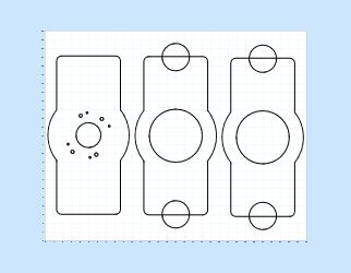

Hello, I have a problem in that, when, I exporting file from CorelDraw it says: “Wrong codes have been found.” what I need to do with it, because I cant open it in Easel, I can see it on my PC but not in Easel.

Is the file that you’re exporting a vector image? You can save something as an SVG and if its not a vector image then Easel will not open it.

Sorry I didn’t notice it, you had some of the circles combined so I broke them apart and saved the image as an SVG and then imported it into Easel. Let me know if this works our for you
