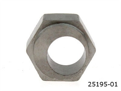

I replaced the eccentric nuts with eccentric spacers and nyloc nuts and (touch wood) nothing has come loose since.

  1. Eccentric nuts are a great idea, but they can be a pain in the arse too. Try loktite on them, because once you have the bolts tight enough, you’re only changing the displacement from center by adjusting the eccentric nuts, not the tension. This should stop them loosening. If still an issues try eccentric spacers and normal nylon nuts.

@KeddyKleinbergs One thing I did to eliminate the need to adjust the eccentric nuts was to replace the eccentric nuts with eccentric washers and use nylock nuts to hold things in place. I have not had to adjust the v-wheels since then (a few months) just like @GeoffSteer mentioned above.
Just for the sake of helping @KeddyKleinbergs and others who may be having issues with this, @ErikJenkins and @GeoffSteer where did you guys find the eccentric spacers? Available at a local hardware store?

I have been tweaking my machine as part of the video that I am making and the eccentric nuts are driving me…nuts ! I found the problem comes when one does the final tighten after adjusting. Despite holding a spanner on the eccentric nut it always seems to go off a tiny bit.
Where can these be bought?

I got my eccentric washers from invetables and the nylock nuts from amazon:

the eccentric nuts on the v-wheels are definitely what I seem to be having the most issue with, especially on the x-axis. In my opinion, Inventabless design doesn’t allow to get everything as tight as it should be for no slippage. To properly torque a bolt and nut assembly you should be spinning the nut, not the bolt and you just can’tdo that with an eccentric nut. Because of the angle you must bring your hex key in the access the button head bolts in the x-axis, again, you can’t get enough torque on the bolt to tighten it down for fear you’ll strip the head, even with a ball end. I have done the blue Lock-Tite on everything to no avail, They always seem to actually tighten on me over time, although some have loosened also, to the point the extrusion is somewhat pinched and the movement of the carriage isn’t smooth. So, I am liking the idea of the eccentric spacer or washer with a Nyloc to lock it in position.

Which eccentric spacers did you guys used exactly, was it the standard ones or low profile ones, I just found a couple last night that were lose and obviously thats not gonna stop. So Im going that route with the spacers and hopefully that would stop or at least make them stay tight longer. Thanks in advance.
I used the standard sized ones, but I will get some low profile ones to replace the z-axis eccentric nuts as there is less room to work on those.

Got my eccentric spacers order from here and threaded standoffs from McMaster… I’ll wait on the socket cap screws, I have a nut and bolt house down the road from me. Convenient, huh?!
