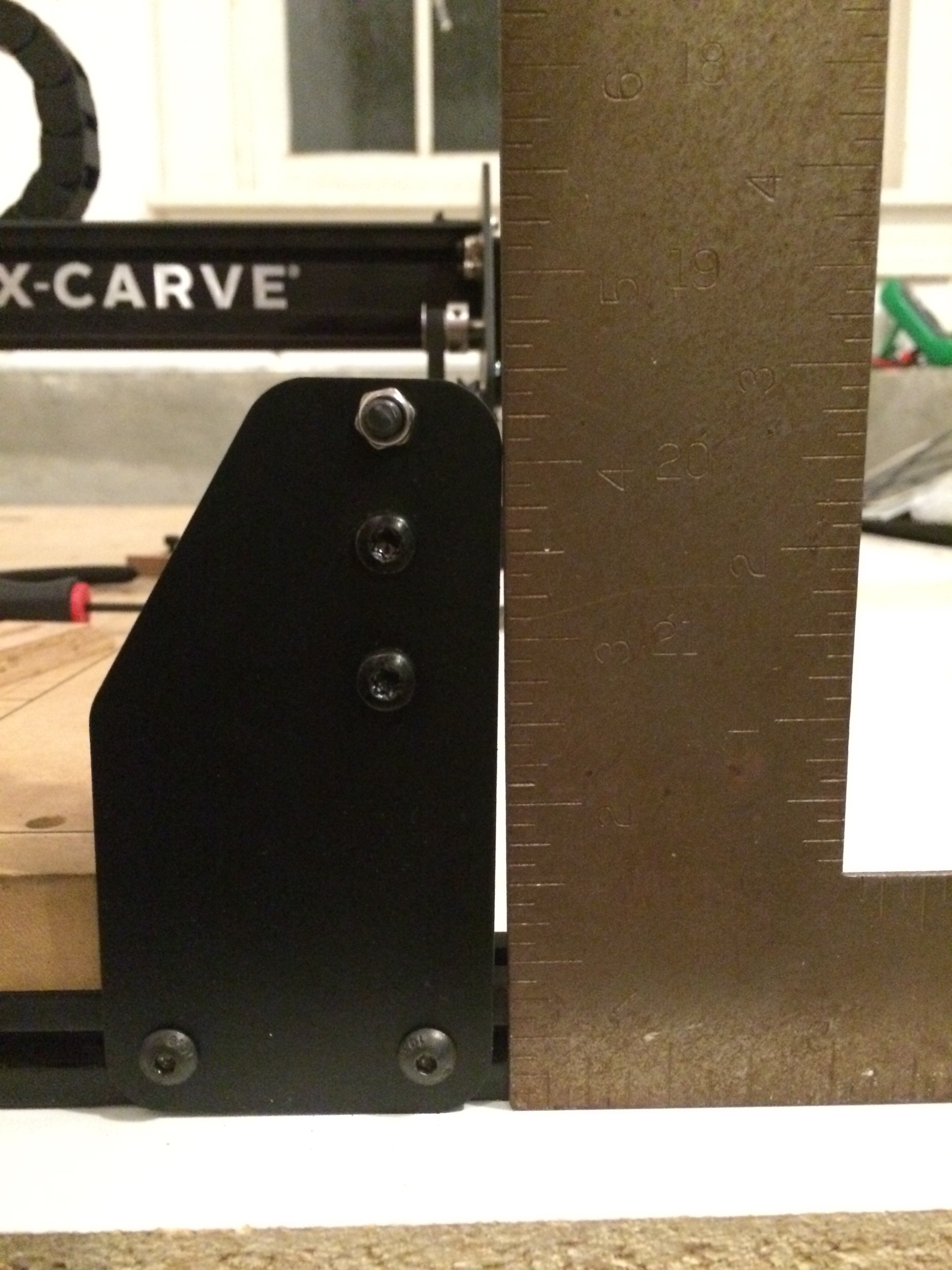

However I’m noticing that the Y axis shoulder plates are all slanted inward, pictured below is the worst offender… However the other 3 are very close, and all slanted outward as well. Which creates a degree of twist on the Y axis rails which need to be flat so the V wheels are traveling along the edge of the rail…
What have people done to correct this?
Plate edge doesn’t matter…is the actual Y rail face similarly off vertical or twisted in the YZ plane? And I mean relative to the wasteboard face not the surface the wasteboard is sitting on, unless you know it to be flat and coplanar to the wasteboard face.
@RichardRemski, Good point, using the square against the Y rails from the waste board reveals much less of an angle.

Using a square from the inside of the wasteboard to the Y rail:
  • Right hand side (w/o drag chain), touches at the bottom, can slide 2-3 pieces between top of rail & square.
  • Left hand side (w/drag chain), touches at bottom, can slide 1-2 pieces of paper between top rail & square.
I’m not sure if this could cause the noise described in the above video or not… But the rails are very subtly angled outward.

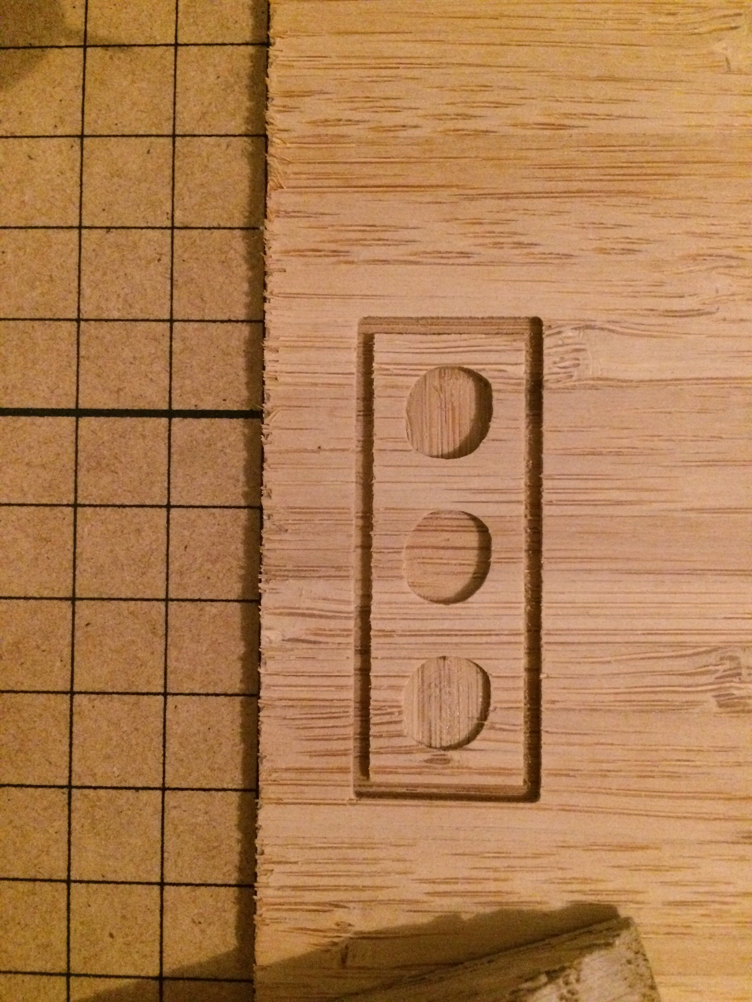

This was my second cut which turned out pretty well. 50x50mm box with a 50x50mm circle; both outline, interior profiles. The box came out to 48.85 wide and 49.75 tall, so quite close for a first attempt.
Something is off with the Z axis however, as my depths of cut were 1mm for the box, 0.5mm for the circle, and 0.2mm for that triangle in the middle.
I ended up measuring the Z depth at: 2.05mm DOC for the square, 1.38mm for the circle, and 0.85mm for the triangle. Onto more reading!

@RobertA_Rieke - Good call! I goofed up and configured Easel with the M8 screw when I ordered the ACME lead screw… Going to go reconfigure and try another cut.
Do you have any suggestions regarding the rectangular cut being 2% shorter (48.80mm to 49.75mm versus 50.00mm)?

The problem is I’m still not getting very “circular” circles. The below photo is of the same drawing repeated 3 times, you can see that the “oblongness” of the circle changed a bit between calibration’s… But I’m still pretty far from an actual circle.
For reference the circle is a fill cut, 10mm in diameter. Measuring the column on the right; the circle(s) are 10mm vertically, and 8.6 to 8.8mm horizontally.

It looks like you’re not getting microsteps on your X-axis, something I’m currently working out on mine as well. It’ll move large distances, but .001" and sometimes .010" movements don’t always happen. To verify this, try moving .001" 50 times or so, and see if there is any change in position at all.

If the Y axis is repeatably making accurate cuts to within <1%, and the X axis is repeatably making cuts that are off by ~14% each time; then I don’t see why this would not be an adjustment problem.

I just wanted to mention that yes, the a well setup machine should make pretty accurate circles. I’ve found the main problems to be
  1. belt’s are loose
  2. v-wheels too loose (I make sure they aren’t easy to spin by hand, by adjusting the eccentric nut)
  3. missing steps due to not enough motor torque (potentiometer set too low)
  4. pulleys are loose on motor shaft
Personally, I’m usually getting squares to match within ~0.01in by checking for the above 4 items. Sounds like you have you have checked #1 and #2, so my guess would be #3.
What is your depth of cut, and have you tried decreasing it? Decreasing it will directly lower the forces on the motor, making it less likely to miss steps.
