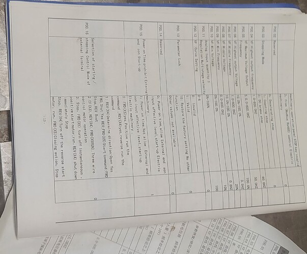

didn’t you get product manual for your VFD, each one is different.
be careful a factory reset, might not be an Inventables reset it will be a manufacture reset.
you should have received something like this. most likely not
no we didnt recieve that. would there be a download from the website?
Kens (and mine) is actually a different brand and model than yours on the XCP. Im sure if you ask customer support for the one for your vfd they will send one that matches perfectly…
For the most part kens would work for yours as well as they are almost all clones…
i was only able to half of its manual
VFD rukovodstvo_polzovatelya___torov_serii_h100_ch.1.pdf (9.3 MB)
There will most likely be a label on the side with a bunch of information that you can grab the exact model from. Then, you can go to the manufacturer’s website and download the full English version.
You would only want to reset the fault. Powering it completely down and then back up might clear the fault. You would NOT want to perform a factory reset…
