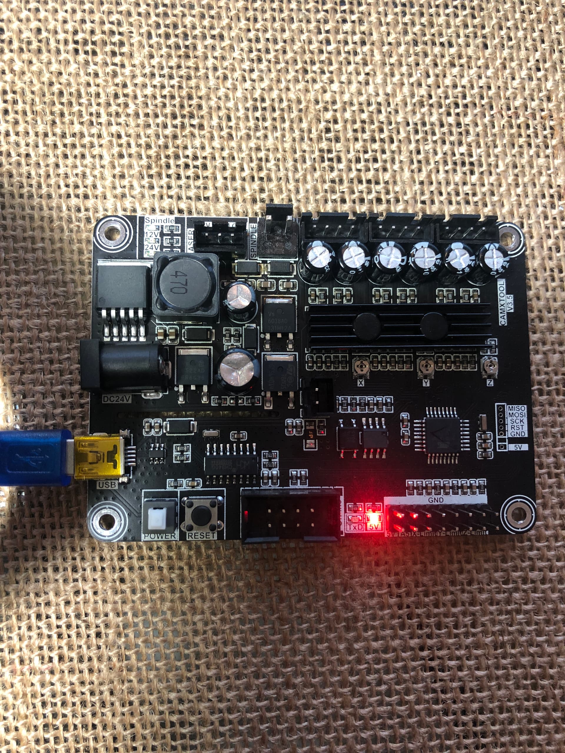

Midway through carving a 6mm indentation on plywood, my spindle veered from its direction and got my router bit stuck when it reached the edge of the indentation. The spindle got jammed, and the control board became unresponsive. I can’t turn it off or reset it. Even when I unplug power supply and plug it back in, the spindle still acts jammed. I can also hear clicking sounds coming out of the power adapter. And when I plug it back in after unplugging, there seems to be a short circuit with a pop and sparks.
I can communicate with my control board through my mac, but all physical commands are unresponsive.
Is there a way I can do some sort of reset on the control board using gcode ? I feel this is what is needed.
you’d want to begin splitting the issue into sections, unlug the USB, this may stop the spindle from spinning, IF NOT then it’s an issue on the controller board. most likely the 12V mosfet that feeds the spindle is shorted and will appear burned or melted solder, this is adjacent the spindle output plug on the controller. this being short COULD also cause the power supply to cycle on and off resulting in the slow, pulsing you are seeing.

Looking at the board, I do not see anything melted or burned (I include a photo). However, the power adaptor cable connector does have a burned pointer. Could this be an issue with the power adaptor?

Photos of control board and power adaptor pointer.
This is your same issue… it is a short in the spindle output Moffett
If you don’t have the part and aren’t comfortable soldering I would just purchsde a new board, they are about $30

Could you help pointing out what is the Moffet that might have the short ? Even though I already ordered a new control board from my supplier, I’d like to try and have a go at fixing this one.
Thanks again Seth ! Really appreciate it
I believe its this one, (#1) but I don’t have the schematic for the v3.5 board to be sure… ir would be one of these 3 mosfets for certain, and usually its as close as possible to the actual spindle plug.
Gotcha ! Thanks for the input. I managed to find a schematic but still having a hard time identifying it (never read an electronics schematic before)
Lovely… they labeled the schematic with a ton of question marks… this is the failed component.
Mine actually failed twice (my own failed twice, I wired in some extra let’s and they shorted out while cleaning out my enclosure)
But the failure was a open (always off). Yours is a short (connected all the time).
https://datasheetspdf.com/mobile/1282127/VanguardSemiconductor/VS6038AD/1
So, just to close this thread. I received a new control board and everything is working again. Unfortunately I had to re-send the damaged board back to my seller for a better deal (he ended up replacing it for free), so I will not be able to fix mine and offer any step by step help. It was confirmed though, Mosfet #3 got fried.
