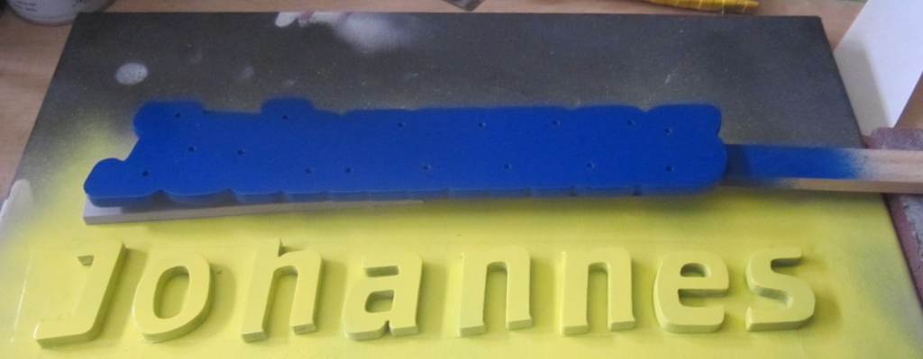

I like to use double sided tape and stick to something to act as a handle that way I can easily hold it at any angle.
The letters are stuck an artist canvas and the the backer to a scrap piece of wood.

I have a cheap lazy Susan that I put my work pieces on and rotate it to cover all sides.
You mean like this? yes I have one also I guess it depends on what I’m painting which method I use.
