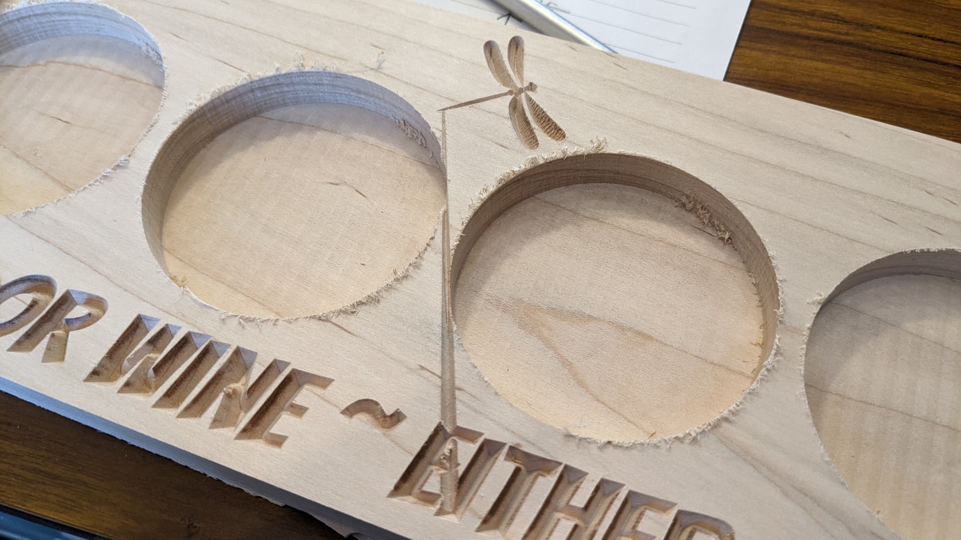

I’m shooting at about 25% of everything I do ends up in the junk pile. Something is seriously messed up with the z axis in this machine. This time I was running at 25 IPM with a 60 degree bit. I’m not running the machine too fast. The program ran on the first piece with no problems. The second piece the head didn’t pick up and dragged across the piece and ruined it. I ran the program a third time and it was fine.
The power could not be any better in my building. I’m using the USB cables provided with the machine. I’m using a $1,000 Microsoft laptop. This machine is running on it’s own 20amp breaker with absolutely nothing else on the circuit. The belts are perfectly tightened. I was not running anything else in the room and the vacuum was not on. I was running the machine very slow. It just randomly messes up in the z axis at random times. I’m at the point to where I no longer trust this machine.

Weird. It doesn’t seem like youre loosing steps on the x axis because all the letters are a consistent depth. The only thing I can think of is a glitch within easel.
I see that you’re using a 20deg plunge and the error looks like its probably around 20deg. Maybe try using a vertical plunge instead.
I just finished up another part with the same program with the ramps and nothing happened. So, 3 out of 4 turned out with the same program. Only the second one glitched. I have the worst luck with everything. My machine probably has a bad controller or a bad z axis. It just doesn’t fail all the time. Just enough to give me a false sense of hope.

While there have been a couple of issues with plunging and toolpaths in the past, I can not seem to generate any errant toolpaths with the file, and the issues that I am aware of were resolved several months ago.
To me, this appears like it is another issue where the Z-Axis did not retract, possibly due to noise within the controller or something that is not quite tight within the Z-Axis. Also, the fact that 3 out of 4 were successful also makes me suspect it is not a toolpath issue.
When you have multiple pieces to carve that are the same file, you can generate the toolpaths for everything. If everything looks good in the preview, download the gcode files, and then use them to carve each piece. If one messes up, you know the toolpaths are already good and nothing was changed, so the issue would then definitely be in the machine/controller itself.

I’d been having the same problems for several weeks. One time my 1/32" ball nose bit plunged through the workpiece, its backboard, and my wasteboard, and was attempting to drill even further, missing a clamp mounting insert by less than a 1/16 inch. Another time it snapped a 4 mm ballnose into pieces.
I reset $1=255, isolated the X-Carve Pro circuit, edited the Windows laptop USB port sleep settings, rechecked the vacuum hose ground, upgraded to shielded USB cables, and finally bought a new dedicated desktop computer. We even installed a modified grbl.hex file, but still it persisted.
Working closely with Inventables Support, I think (hope) we’ve finally narrowed it down to the Motor Lock/Unlock feature. It appears that for the X-Carve Pro, using the Motor Lock function between bit changes was causing my detail carve to mess up on the Z-axis.
It appears that for the X-Carve Pro, at least, that we should not use the Motor Lock function at all. Easel’s Walkthrough Tutorial for Rough/Detail Carving does state that: “It’s not necessary to lock or unlock your motors if you have homing switches as you will re-home the machine after changing the bit.”
I’d been following 2-Stage Carve instructions apparently meant for non “Pro” machines and had been using the Lock/Unlock. Since then, I’ve not had any more issues…

I have only run half a dozen or so projects on my 4x4 X-Carve Pro so far. On two of these, I had the machine all setup for the project, probed the Z-probe and set my origin. Then when I ran the project the machine immediately buried the bit into the workpiece and cut a large gouge in the project and broke the bit, before I could stop it. After the second instance I did some thinking to try to figure out what I had done differently in the two failed efforts, as opposed to the other perfectly successful runs. What I discovered is that, after I probed the Z-probe, I raised the Z-axis to clear the workpiece and facilitate installing the dust collection boot. Both of the unsuccessful runs, the Z-axis was accidentally run all the way to the upper stop in this process. My theory is that, in doing this, the machine lost the true position of the bit and thought it was higher than it was actually able to go because of the stop. Since coming to this realization, I have avoided hitting the upper stop and, if I do accidentally go that far, I subsequently re-probe the Z-probe before running the project. I have not had any ruined projects since then. I hope this helps.
If you set $20=1 then you will get an alarm when you do hit a switch, then you’ll at least have a chance to redo the probe and try again without the lost steps…

Inventables sent me new firmware through email and the correct GRML settings. They were different. I don’t remember what changed, but it did seem like at least 3 or 4 settings were different. There was a newer version of Easel driver available. They really need a banner at startup telling you Easel driver needs to be updated.
I’m not sure what made the change, but I’ve ran 6 projects now without any indecent.
Possible causes for my problems…
$1=0 wrecked stuff
Easel Driver malfunctioning and wrecking stuff
Easel glitching and wrecking stuff (ramping v-bits. don’t do this.)
GRML settings not exactly right
Firmware not running the machine correctly (possibly motor locking issue?)
