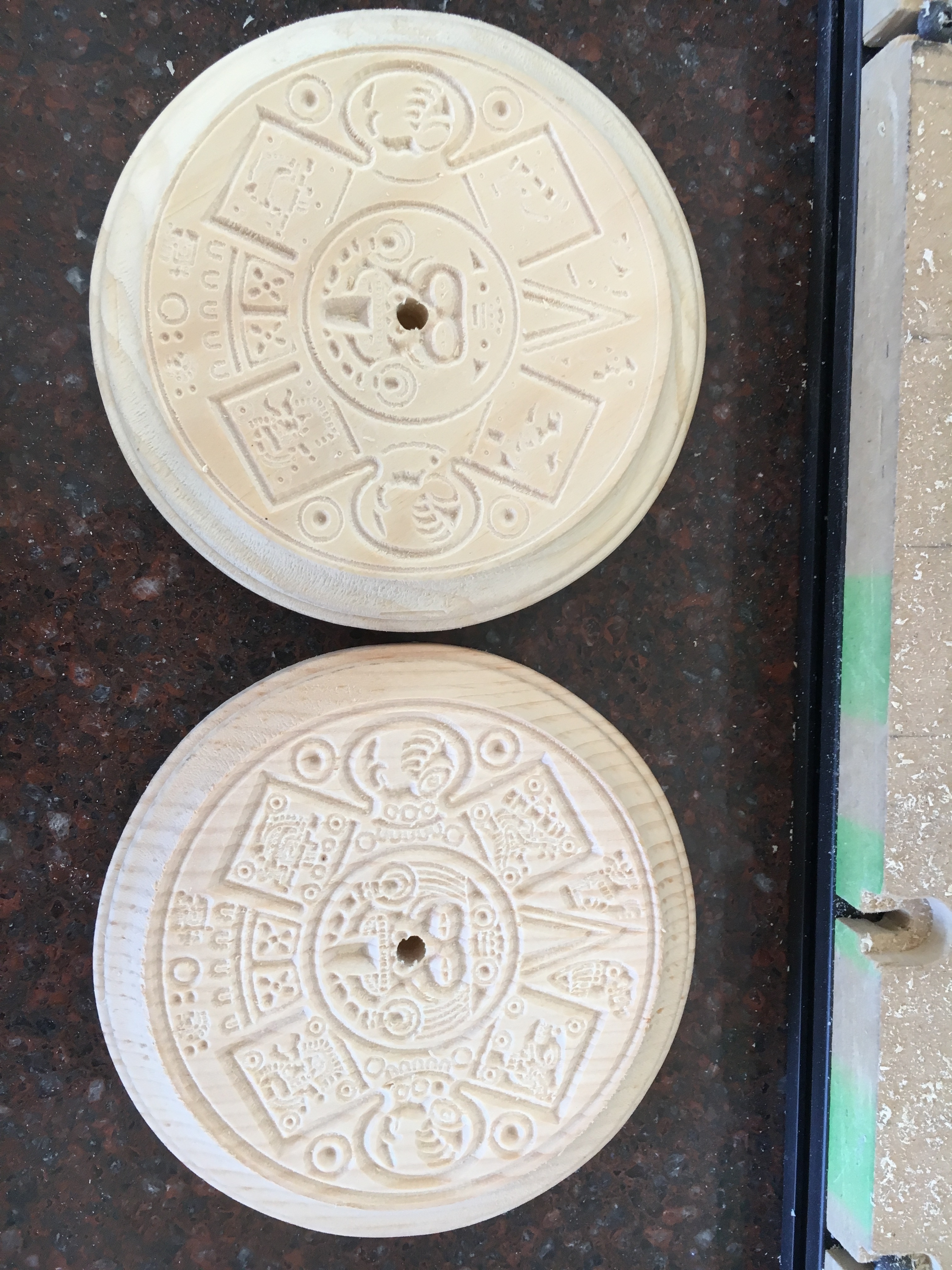

5" total. 4" carve. 90deg vbit. amana with replacable blades rc-45711. 75ipm.
bit was too high on first pass. I did a clearing pass with a 3/4" router bit at 0.05"… win. Fun to go at 100 ipm and make big chips!

Nice! How long did the carve take?
15-20 min. its just a 4" piece.
