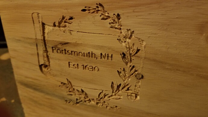

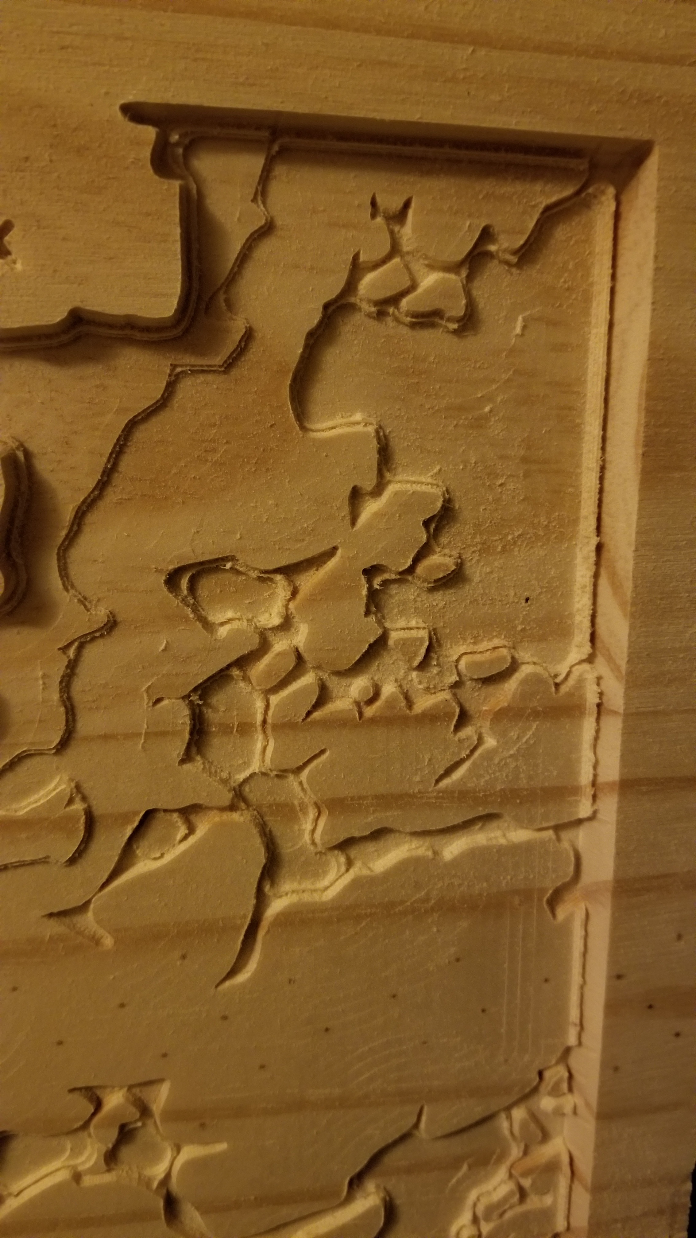

Here is some pics of the carve done. Several thing to correct and some clean up to do.
