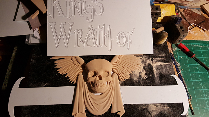

This weeks assignment to recreate a clients product logo in relief. X-Carve running flawlessly today and getting things done in a fraction of the time. Thanks, Inventables.

what material is that? is it urethane foam?
Yes, it HDU board. I’m going to hit it with auto primer to fill the pores.
is this modeled or was it an image?
I modeled the skull and cloth but did the wings in easel with cutting layers.

what is the white material? polystyrene?
Holy cow that looks amazing. You said you did the wings in easel? Can you explain how you did that?
Just multiple layers, Frank. I spent a little extra time setting up the file in Illustrator.
