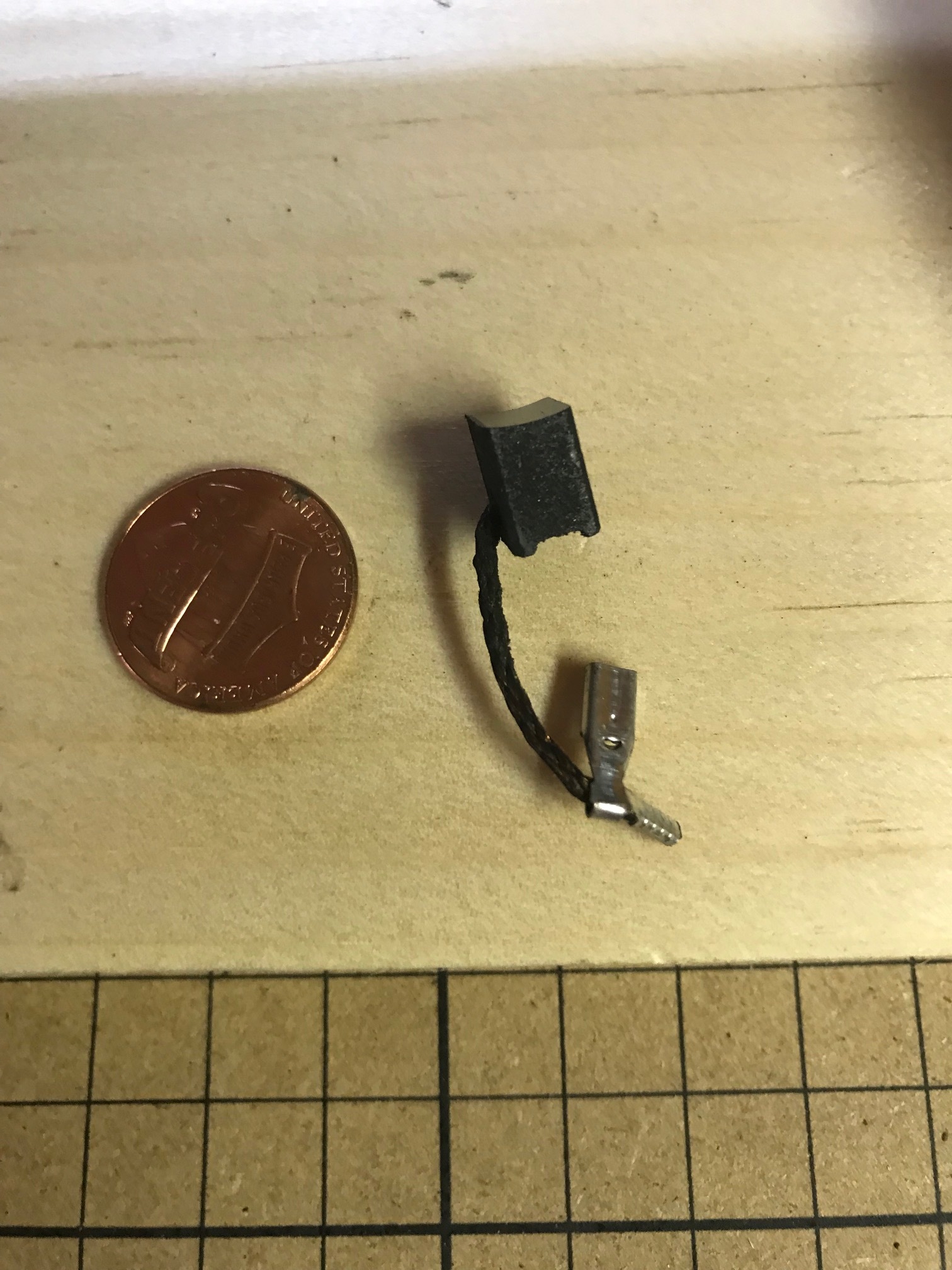

My router stopped working. I was starting to make noise then simply shut off
I took the brushes out and the pic is what i had left. Does this look like they are used up?
That is about the time I change mine. Here is a video. https://youtu.be/fQzFfuG-GrM

Thanks. i was just wondering if they were too worn to work and that was causing the router not to run
@Stacy. Most likely. I have had the router stop. I blew air into router to clean everything and put brushes back in. It worked only for a short period. It is time to change brushes. I have a link in the description to order them. That way you know you have the right ones and save time hunting for them.
