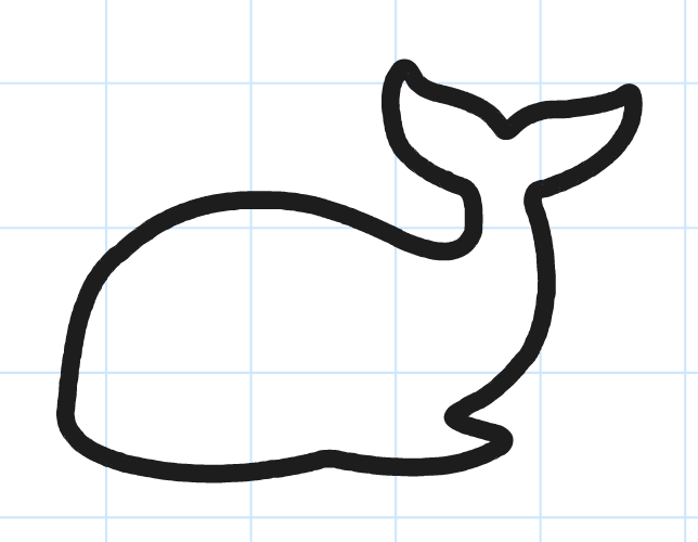

The tool path I created required the z-axis to go down. All it did was float in one place as the path continued. It never stepped down into the material to make the shape. What am I doing wrong?

I just ran your projects and there is something weird in the code.
It immediately performs some plunge operation that is not visible in your image.
The error is in the line art for the elephant. I deleted it and it ran normal.
Redraw and import the elephant and you should be ok as long as no other mechanical issues with the z.
You have an open path and a segment causing Easel to drill down to full depth. If you have any slippage on your z, that is where it is getting you.
It is right inside the front leg of the elephant.
Thanks for the help, that did it.
