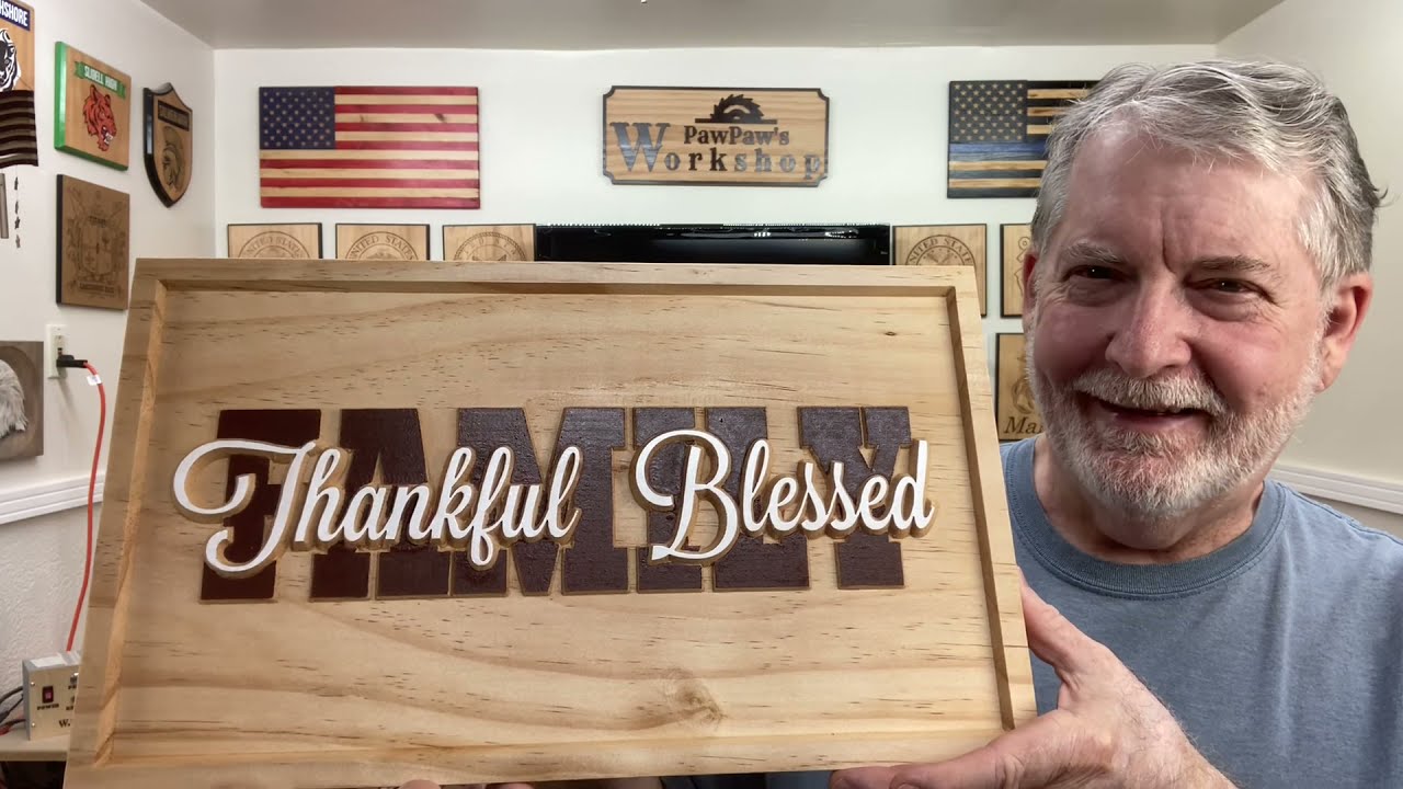

If you set the, “Home”, cut depth to 0 and the, “Welcome”, cut depth to something below that, Home will be on top.
do i have to set the initial retangle to a depth or just leave it
The rectangle would need to be set to the back and it would also need a depth.
I usually do 1mm for the text, and 2mm (1mm deeper) for the rectangle.
