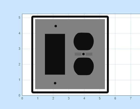

Designed wall plate cover but can’t seem to get the cut outs right. Material removes OK but wont perform/cut openings. Holes cut thru OK…
Hi,
Can you mark the project as shareable so we can see it?
Thanks!
Think I just got it shared…
Think I just figured it out…sent to back…
Yup, looks good to me!
Having trouble getting aligned…any sources for covers shared?

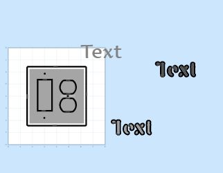

Is this what you are trying to do?
Yes…thank you
How did you design the outlet profile…?
What material and thickness do you cut these from? Store bought cover plates usually have rounded over edges. Do you subsequently sand/route the edges to look similar?
