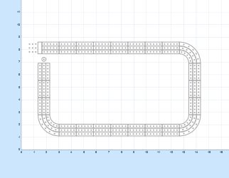

I have the following problem when importing .svg file that is created in Visio.
Can you share the svg?
Here it is
Every one of your circles is grouped with an odd path that’s tough to see.
The lines are also a bunch of stacked rectangles with duplicate paths. The corners are separate objects. It’ll take some work to fix the SVG.
No idea what I could have done wrong. Will go back to my original Visio file to have a look what I could have done wrong. Thank you very much to have looked into it Neil
Don’t know if you’re still having trouble with this, the curves were lines and I changed them to shapes
