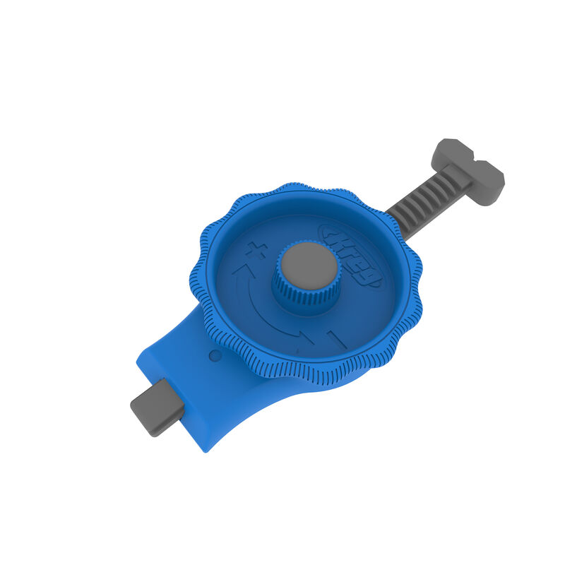

@RobertCanning 's suggestion for a cam clamp is an interesting idea. It reminded my of a horizontal cam clamp by Festool which is prety $$ btw.
https://www.amazon.com/Festool-488030-Clamping-ElemenTS-2-Pack/dp/B000JNEC1Q/
Also, there’s a subtle design aspect that can make a big difference. It was missing from the first concept over at the other thread, but I see you added it here: a way to bolt down the adapter to the track. If you omit this, you might be overstressing the T-track.
So far you have limited the move of the adapter along the track. There’s one degree of freedom you need to remove as well: the T-nut pushing up and bending the T-track open. In order to do so you will need to add a spacer high enough so it clears the wasteboard. This way you sandwitch the T-track between the spacer and the T-nut and you can then tighten the bolts that hold the adapter without fear of damaging the T-track.
This is best drawn than told. Give me a minute.
Voila…
Now the tricky part is how high should a spacer be if everybody has different wasteboard thickness. Not to mention that periodically people resurface their wasteboard. Well, a stack of washers with a dia of approx the T-track’s width could do the trick as well. Then you could add or remove at will.
I don’t see any give on my tracks and I have to crank the hell out of them sometimes. My local BBS has a horrible supply. More bows than the local archery shop.
Bending the T-track open is very unlikely to happen. Bad choice of words. What I am trying to point out is that if the top (open) side of the T-track is not sandwiched in such a configuration, there’s an open channel trying to fight an upward force. How much it can take, depends on that force. T-nut or T-bolt makes no difference in that case.
Btw, here’s another one for inspiration.
For the same reason discussed above, these work best when T-track_height >= bench_height (all product pictures are shown in such setups).
Now, these people got it right. See the little gap between the wasteboard and the clamp? There’s a spacer underneath. There’s a recommendation in the user manual (leaflet). I know cause I use these ![]()

How about skip the t-track and use 3/4" holes in the wasteboard. Then you could squeeze the material with these new Kreg clamps. They caught my eye a couple of months ago, I really want to try this.
