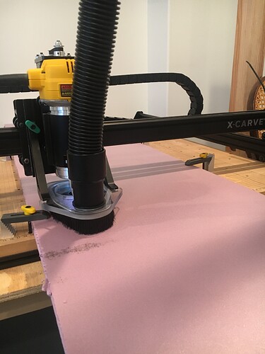

I got a paid job to make some letters for a conference logo. I used a bit with a 2 inch cutting area and pink foam from Home Depot. The letters were painted and mounted to a metal frame giving them a floating effect. I was able to cut each letter using a 2” depth per pass so the whole letter was cut in one pass. I ran the X-Carve at 220IPM. It was really fun to run it that fast.

Funny story about that bit. I didn’t want to spend a lot of money so I dug through the bits in our makerlab at work and found a bit that was 2 inches long but had a inch of cutting area. It wasn’t designed for foam but I figured I could get away with it. I was wrong.
As you can see in the picture the rubbing from the bit melted the foam, clogged up the bit, the machine started going off course from the friction and build up foam molten foam and then my dust collector got caught on the clamp and I broke the acrylic piece in a large SNAP sound.
So then I went on google to find the proper bit. I searched and searched and found one that I thought would work but I MIS-red the specs and it was 2” total rather than 2” cutting length.

@PhillipDanner it cut very well and if I had to do it again I’d try speeding it up to 300ipm.
Each letter only took about 1 minute so it might be unnecessary to change the settings.
