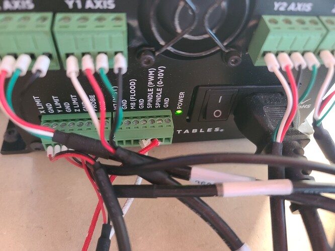

BUT you can certainly make your own mount and cut and run the right length wires and Save a few hundred $$. This 10W output Atomstack M50 is only $330
Check out this AtomStack M50 on an Xcarve.
The AtomStack includes the needed power supply and a back bracket which makes fabricating a custom bracket a bit easier. . . and it plugs into the Xcontroller using the PWM and Ground (the exact same connections as the Jtech)

Does it comes with all th cables too ?

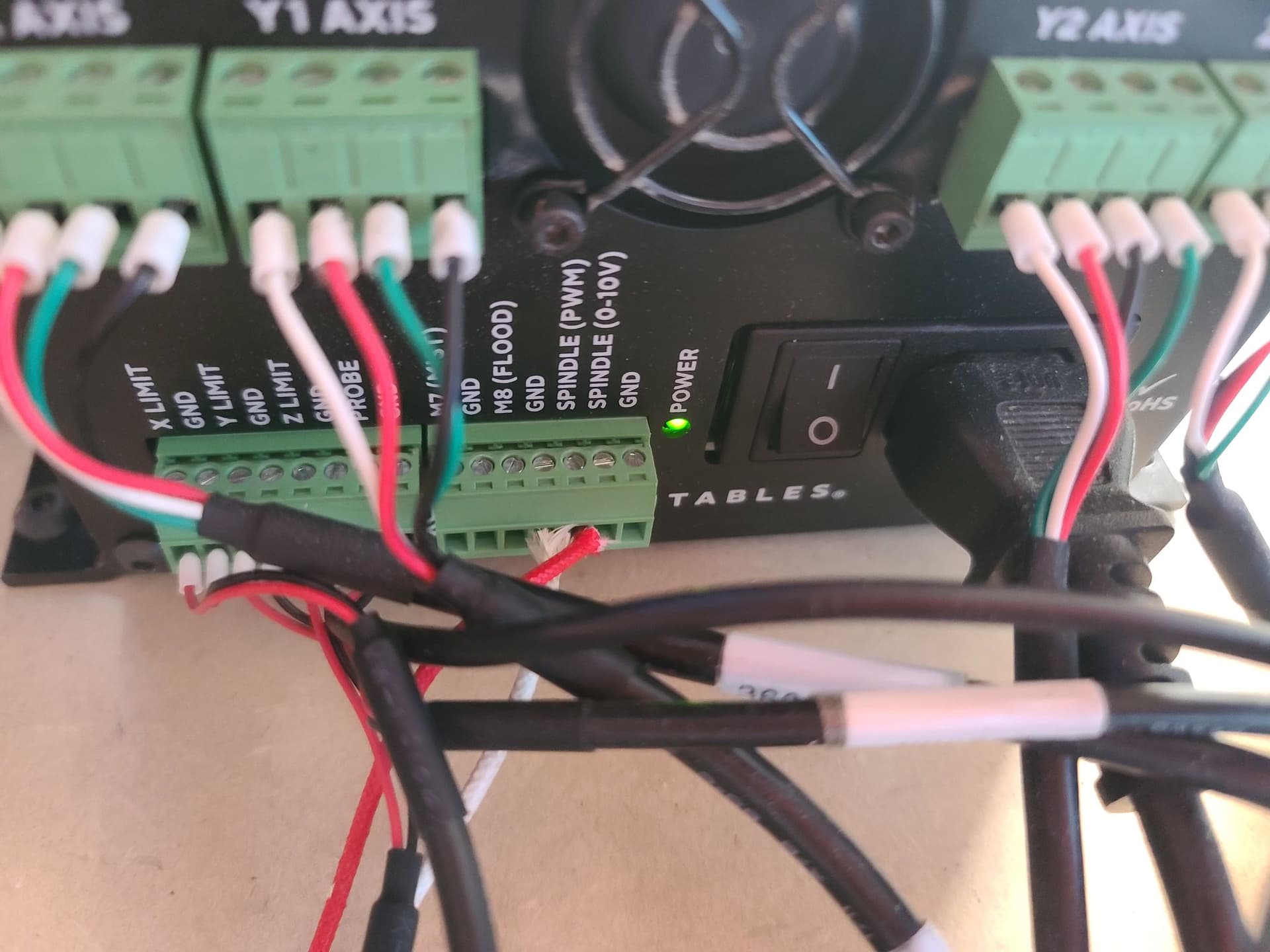

The signal wires included are too short to run though the cable chain on a X-carve so you’ll want to use some replacement wires for that part. They are just signal wires so the gauge isn’t critical, 28AWG to 22 AWG would be fine.
And you’d want to measure out the length needed for your setup.
These are the White/Red wires from the photos above (and the Red/Green from the drawing)

Do you mean that the driver is included ?
About the first picture… is it it the driver that sits on top
beside the gentry ?
Ohh the driver board, I’m sorry i read driver and thought you meant like firmware in the computer kind of driver. Like the drivers you to manually install for Easel ![]()
Yes that board is included with the M50 kit. And the power supply input power to it is alson included in the kit.
Meaning the only missing stuff is the signal wires and the bracket.
