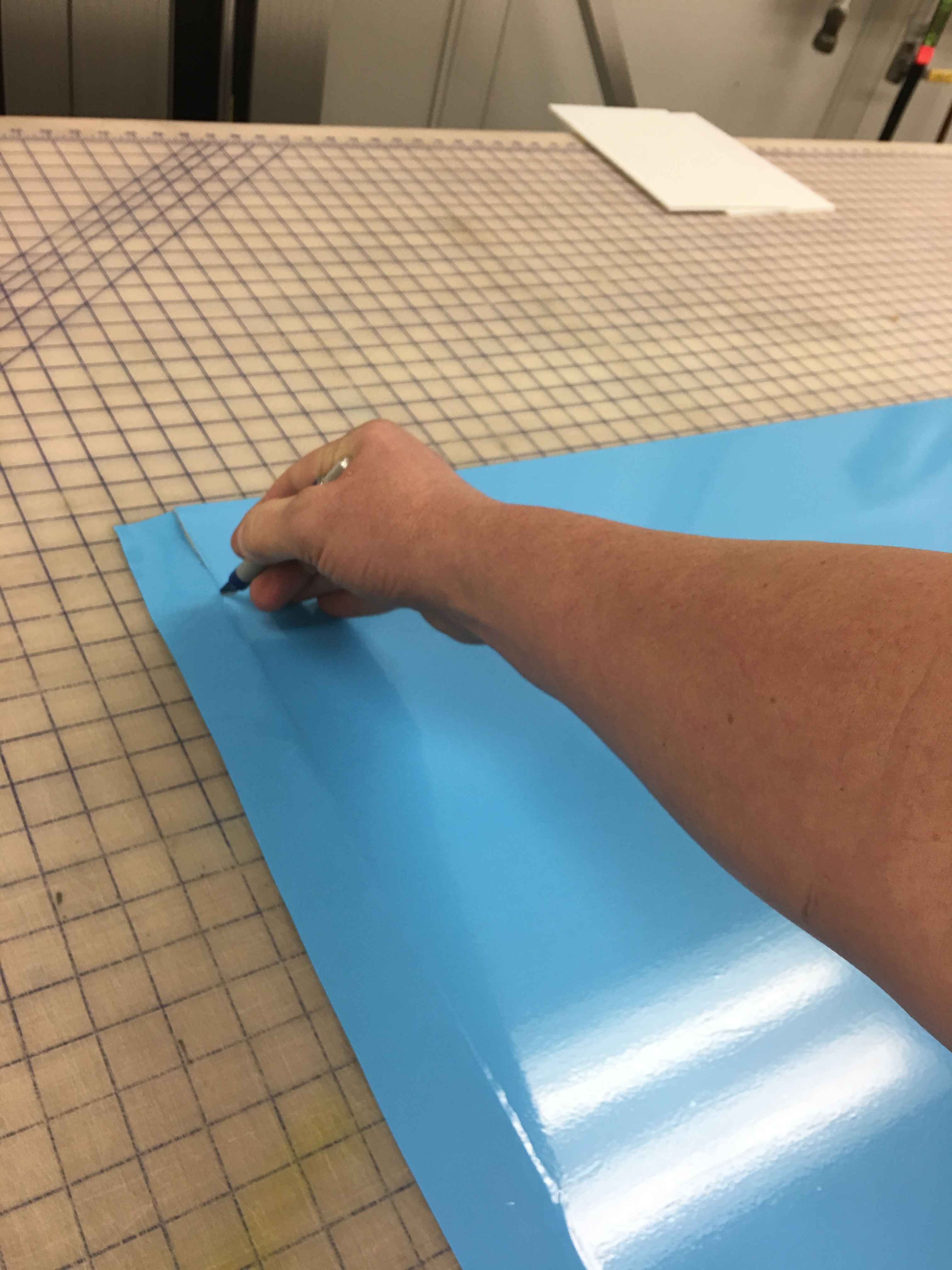

It’s hard to explain but I will try,
Cut the piece of oramask needed
Lay it on your substrate
Place a piece of tape across the oramask about 1/3 the way to make a hinge.
Fold the oramask at the tape and peel off the backing.
Cut the backing and pull the corners of the oramask and squeegee down.
Then fold the remaking oramask over and peel the backing off while sticking the oramask down.
Edit: Sorry some of the picture are out of order, I took them and sent them from my cell
