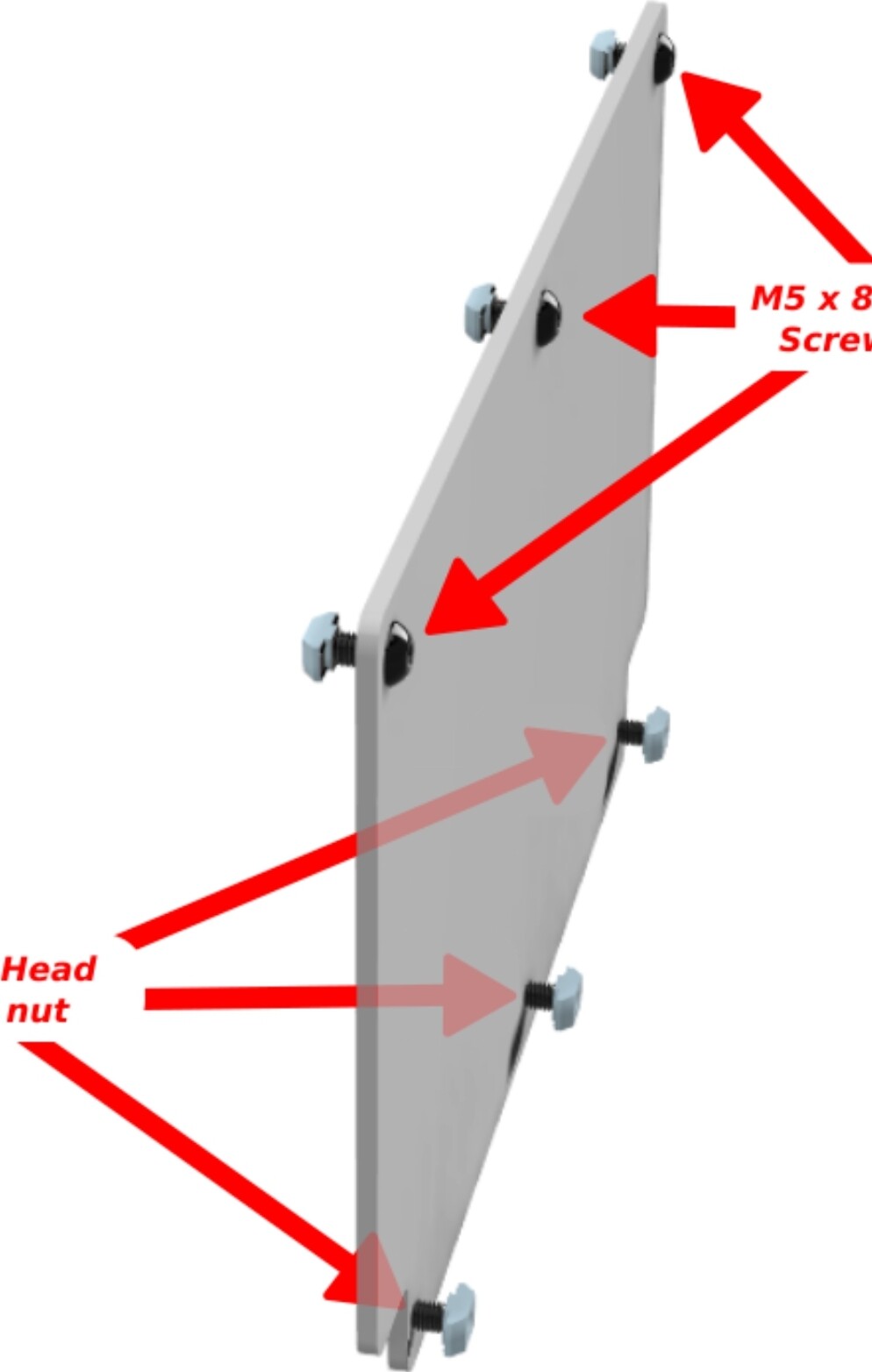

The tee nuts don’t stay in side the slot when being tightened. They just rotate until they’re horizonal, making it impossible to install the stiffeners.

They should rotate as they are turned clockwise and they will only rotate 1/4 of the way and lock into place… now they need to be fairly loose on the screw in order to rotate properly… if you look closely on the example photos you’ll see that they are maybe 1/2 a turn on the screw as this will give then the ability rotate rotate into place.
That said I don’t love those rotating the nuts when they are hidden behind that plate… I rather see the slotting ones that you have to slide into the slot and they don’t rotate at all… but lining them all up to get into those slots would be equally painful.
I just want an answer as to how to get the tee nuts to stay in place. Check it…
The tnut on the left is one that came with the original CNC. The one on the right is the one that comes with the upgrade. Imagine trying to tighten a screw attached to the new one. Because it’s so narrow, it just keeps turning round and round. Chances are, it’ll stop turning in a horizontal position - that is, not in the slot. Which is useless.
Notice that the new nut has a bit of a bump where the screw entered. I believe this is there to “catch” the slot opening to stop it from spinning. But this bump is too short to actually do that.
Me thinks these are the wrong tee nuts for this installation. What do you think?

I think I’m with ken on this one… ive used these I 5 other cnc builds and they’ve worked perfectly, u surethey aren’t on the screw backwards?
So when you say, “on the screw backwards”, do you mean with the bump pointing away from the opening? No, I’m sure that’s not the case. But I’m encouraged by your optimism. Maybe I am doing something wrong. But I don’t think that’s it. The bump just isn’t catching for me. Why could that be?
Ah, that’s what you’re saying. → Except the nuts shown in that picture are the ones they sent with the original unit. Refer back to my picture. The upgrade is using the other ones, which just rotate out of place while being tightened.
