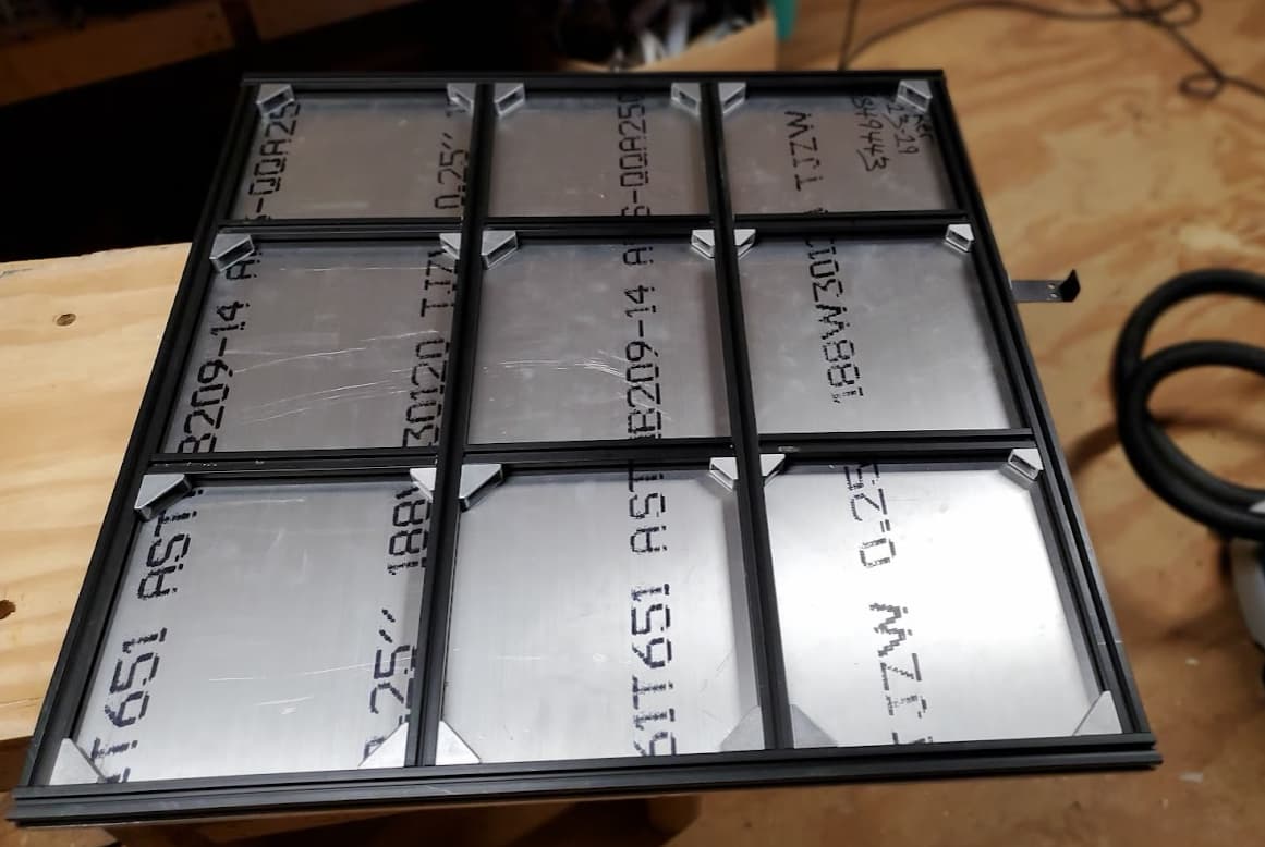

Here is the underside of mine when I was upgrading it.
You can also find all of the parts at other online retailers as well if you wanted to go that route. Even if the extrusion you buy is slightly too long, you can easily cut it with a miter saw (if you have one).

I used 40 screws that were countersunk into the aluminum base connecting to t-nuts in the extrusions below.

Yeah, I think my total cost for 1/4" plate 6061 for a 750 X-Carve was about $120 from Speedy Metals.
Magnets are your friends when moving around those types of t-nuts to align with holes.
My upgrade came before Inventables created their new wasteboard design, so the layout is different, but you could put holes in the aluminum anywhere you want to. Again, the aluminum base isn’t required, but I wanted to go that route several years ago.

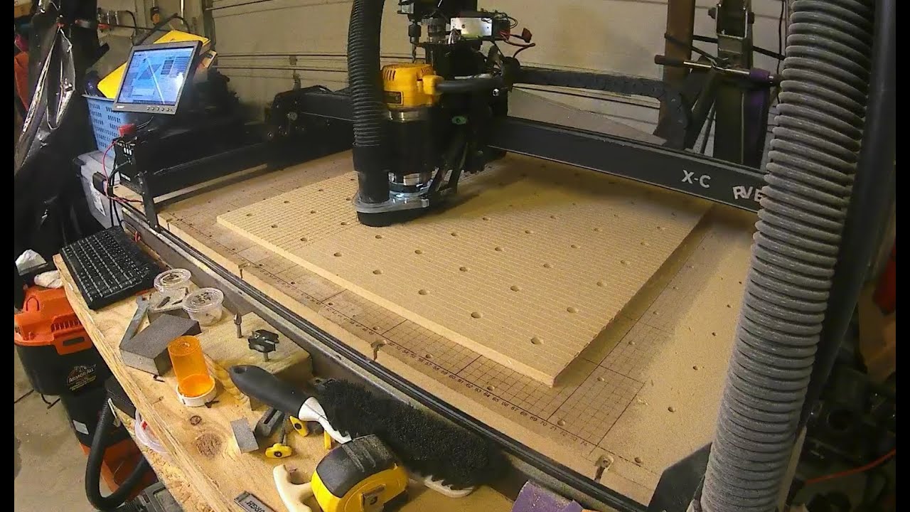

Some before pictures….
Not exactly what you’re looking for, but here’s a video I did of installing and surfacing an MDF spoilboard onto my XCarve 10000
