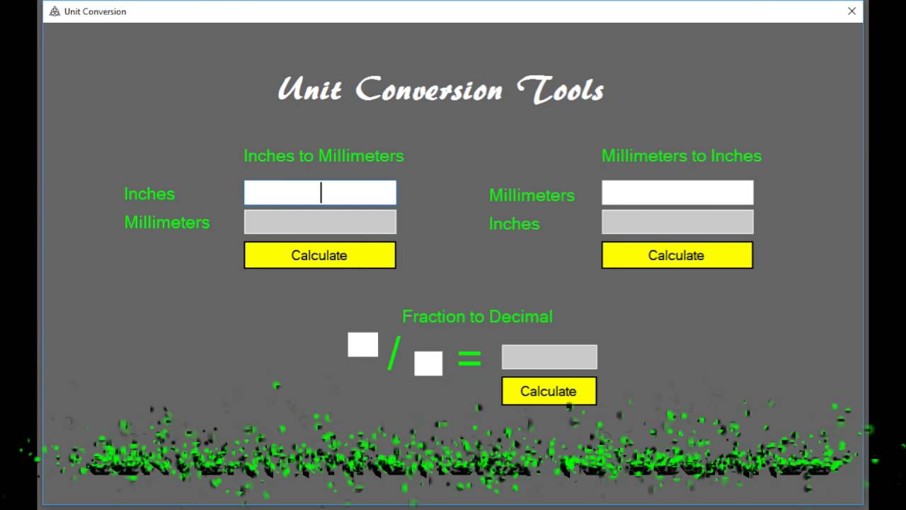

I have been working tirelessly on a new software package for the Triquetra Auto Zero Touch Plate. It is still in Beta Testing for now but should be released in the very near future. Here is a teaser video:
I’m looking for a Beta Tester that runs Windows XP, Windows, Vista, Windows 7 and Windows 10.
