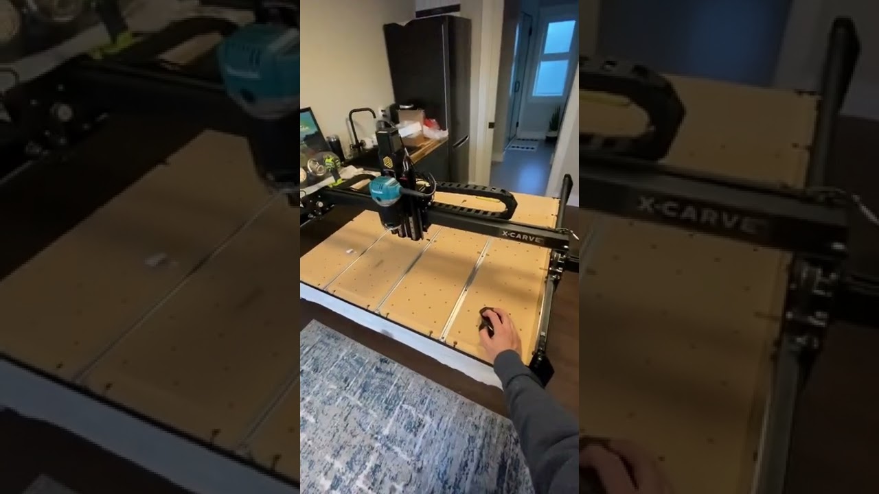

Brand new setup, Y-Axis is not working. almost like motors are going in wrong direction, when I disconnect 1 Y-Axis it works, but slug-ish and vice-versa, when I cannot them together, Up moves right, down moves left. I dont understand! Hopefully video helps.
Most likely you have both y stepper motors wired the same. 1 needs to be wired backwards of the other. If you double check the instructions it will tell you how to wire them.
What Wayne said.
There’s a wiring schematic in the assembly and it has you swap a pair of wires on the Y2. You’ll need to go back to that and verify, just swap back if yours is wired per the manual.
