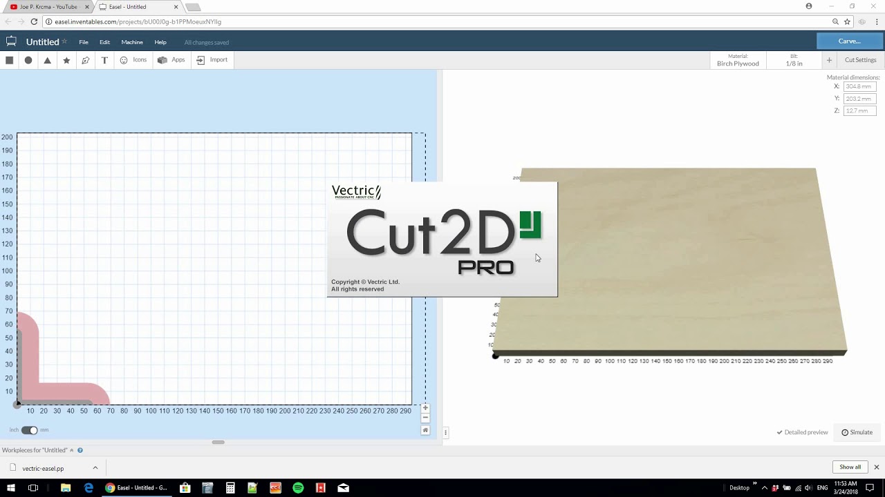

You now need to open this back up and save the toolpath as a gcode file using the Easel Post Processor (if you want to use Easel as the sender software)…
Using this button…
you’d also need to use the Easel Post processor which isn’t pre-loaded into Vectric, so you’d have to do this first in order to use the right Easel post processor too…
When you save your files in vetric you need to save the code in your post processor language easel/Inventables has a video on this subject which is how I figured it out
