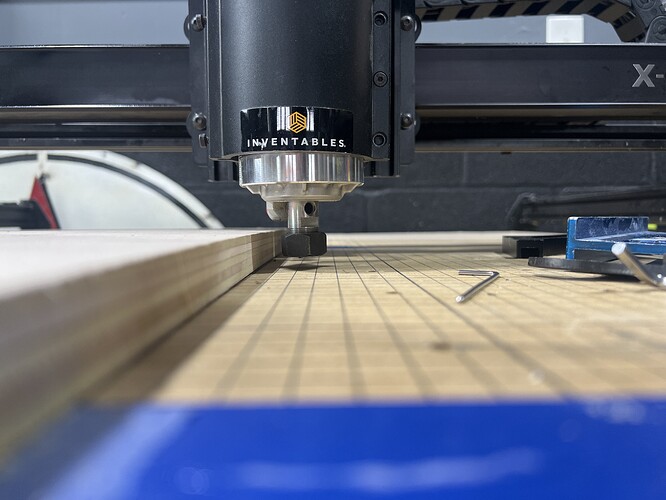

I am using Easel Pro, and first off i bought a used machine, he said he did some updates and one of them was updating to the makita router. So honestly i truly feel as if my initial download or my set up is off. I uninstalled the machine several times and tried several different methods. I have watch paw paw workshop on how to calibrate i have a MM ruler ordered, but my 101,102,103 i have played with it set up the old way and the new one way compared to the 2 options I had to go off of even took some off of one to see if it would bring my z Axis down because now i have got the X,Y fixed i think, now the Z is cutting air. I have made 4/5 cuts and 3 was just a fail from finishing but the cuts weren’t amazing just did the trick for what i was practicing with. Just started a regular project I had designed but the machine did good except on 4th one i went to do the 2nd pass and it was off. 5th one was completely off to the right. Now i go to cut and the depth is cutting about a 1/16 of an inch above the surface. I physically measured my material with the little hand tool and it made it closer but still not the .06 i was trying to cut. .032 per pass as default. 1/8 downcut bit i adjusted it and checked videos on how to put the bit in the router correctly. I am new at this and followed several videos for half a day today. checked the settings underneath the hood so to speak on my x controller, everything lines up from what i read on this forum. turned off the number 4 on all of them as a few had mentioned to do. I adjusted it the machine with the screws holding the router to it and put it down a little further then it was set up by the person i bought it from.
I was starting out in the left bottom corner, now this one where it’s cutting air i tried doing everything from the center
my terminology is probably not as good as some of these posts but i’m game to figure anything out. I really want to get this thing going as just my 4th and 5th cut fails I ended up finishing decent and now have 10 projects to make for customers but machine is not right to start wasting material but has got to be a user malfunction i hope

i am just trying a few different things but i have my collet all the way to my material and its .409

I see something of concern in those photos, there’s 2 of the 3 spindle clamping screws missing. Making me believe that it’s possible for the router to move (up) within the clamp… Maybe these were out for your re-positioning and you replaced them and tightened snugly before running the machine, hopefully? Also, I would place your shortest bit in the collet, and ensure that bit can touch the wasteboard. No need to mount the router any lower than that position. Mounting too low with that Z axis can cause the Z to top-out in some instances, hitting the physical limit at the top of the Z axis which can cause failed carves from that issue…
How are you setting Z zero prior to running the carve? (using a Z-Probe or paper method?)
What are all of your grbl settings?

I will post my settings, also my z probe i normally go probe it in the center of the material and then zero in the left corner, i tried to do it from the center and it thru my depth off made me cut air

Using center WILL NOT cause this, if you experienced this than something else in the carve setup was performed incorrectly. Possibly the Position of the spindle too high in the clamp, Z zero not set correctly, incorrect Z probe thickness setting, etc. However my point is that using Center does not cause this outcome, Ever.

Something to take a look at is Whether the Z Probe thickness in Easel matches your ACTUAL Z Probe thickness. To see this setting go to Machine>Edit Machine and at the lower left you’ll find the probe option and the settings button to see what the current thickness setting is. You’ll want to measure the probe to ensure these match up.
IF the cnc is correctly calibrated, and the Z Probe thickness is entered correctly, AND there’s adequate Z travel for your shortest bit to touch the wasteboard without being so low that the Z doesn’t lift into hitting a physical limit of travel at the top or bottom, than the issue you explained of not having correct depth should not be an issue…

Yet i have not gone thru and checked everything you mentioned which i will be doing, i did make a successful cut! It lined up, my depth was still off, i do have a tool to measure my probe and i was able to do that properly. This cut was somewhat successful as my depth was still off but i changed my probe settings which gave me the depth i needed. I do believe you are onto it. I have a complete Z upgrade coming for this. As far as belts go, I do believe i have an issue here and this could be the root. When i bring my machine as frontwards as possible my left side hits but my right (facing the board) i have to keep pushing the button

Seth and Brandon! THANK YALL! Got the upgrade kit on and was able to get a successfull cut!! Just hope it stays this way
