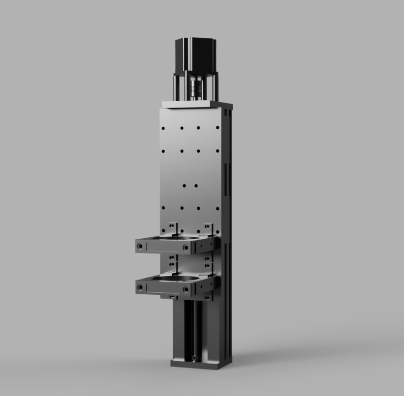

Planning was done in Fusion360, for the whole new cnc machine, here a picture of the planned z axis:

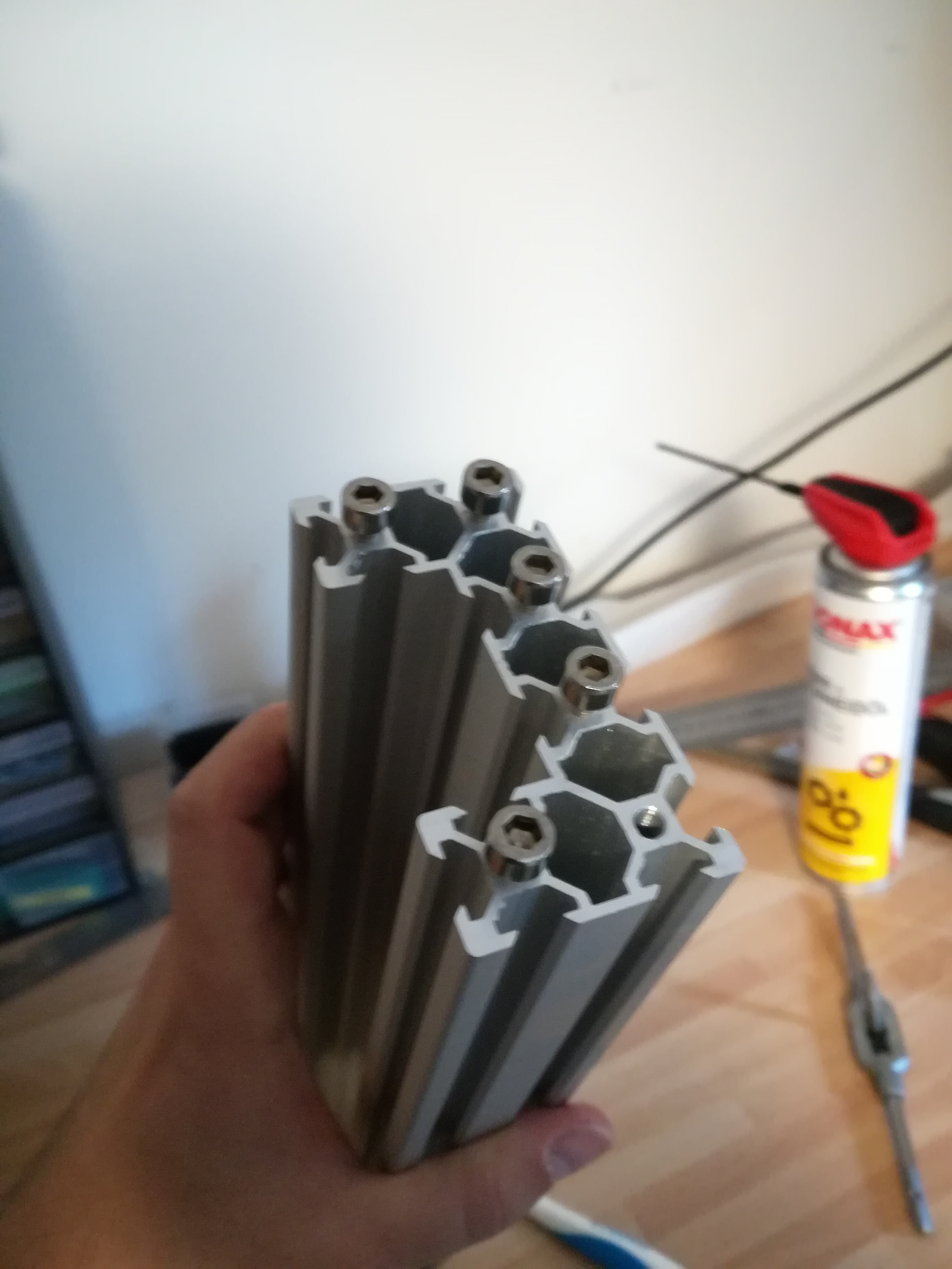

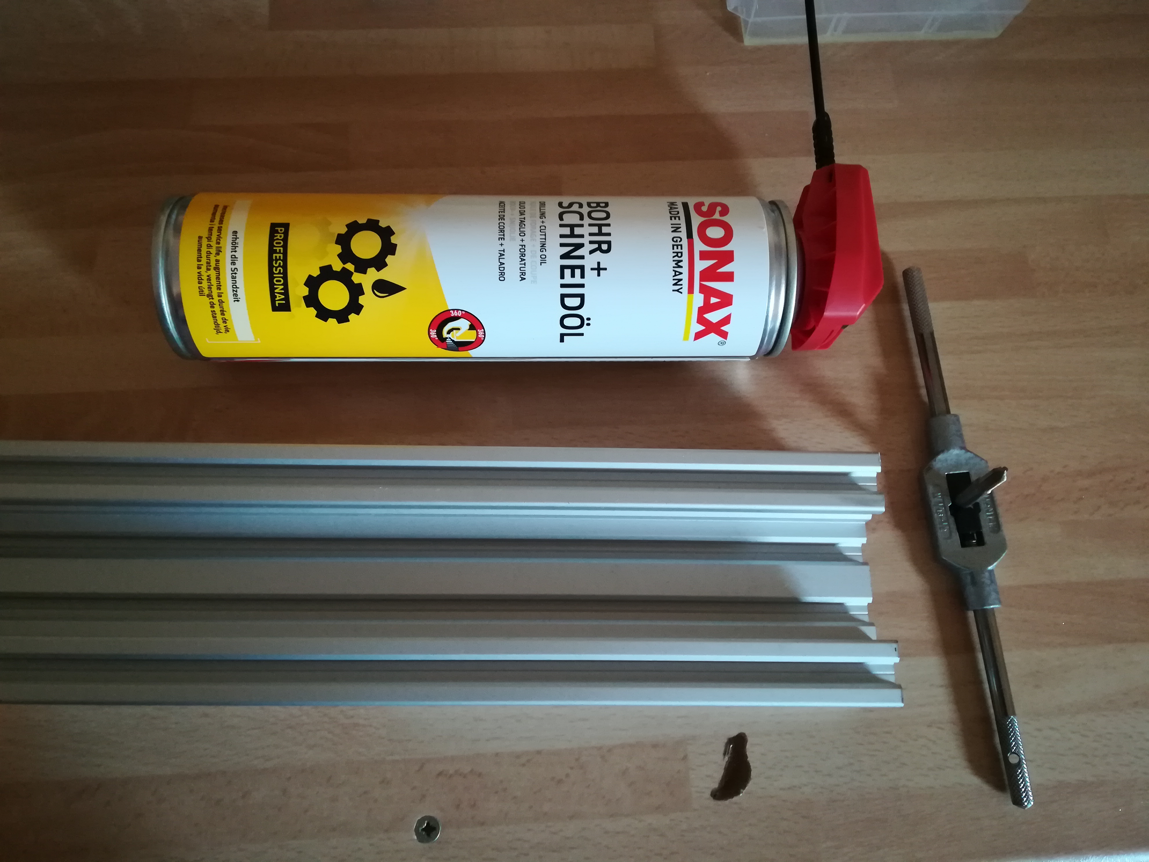

At first I needed to cut the c-beam to length and tap the holes:

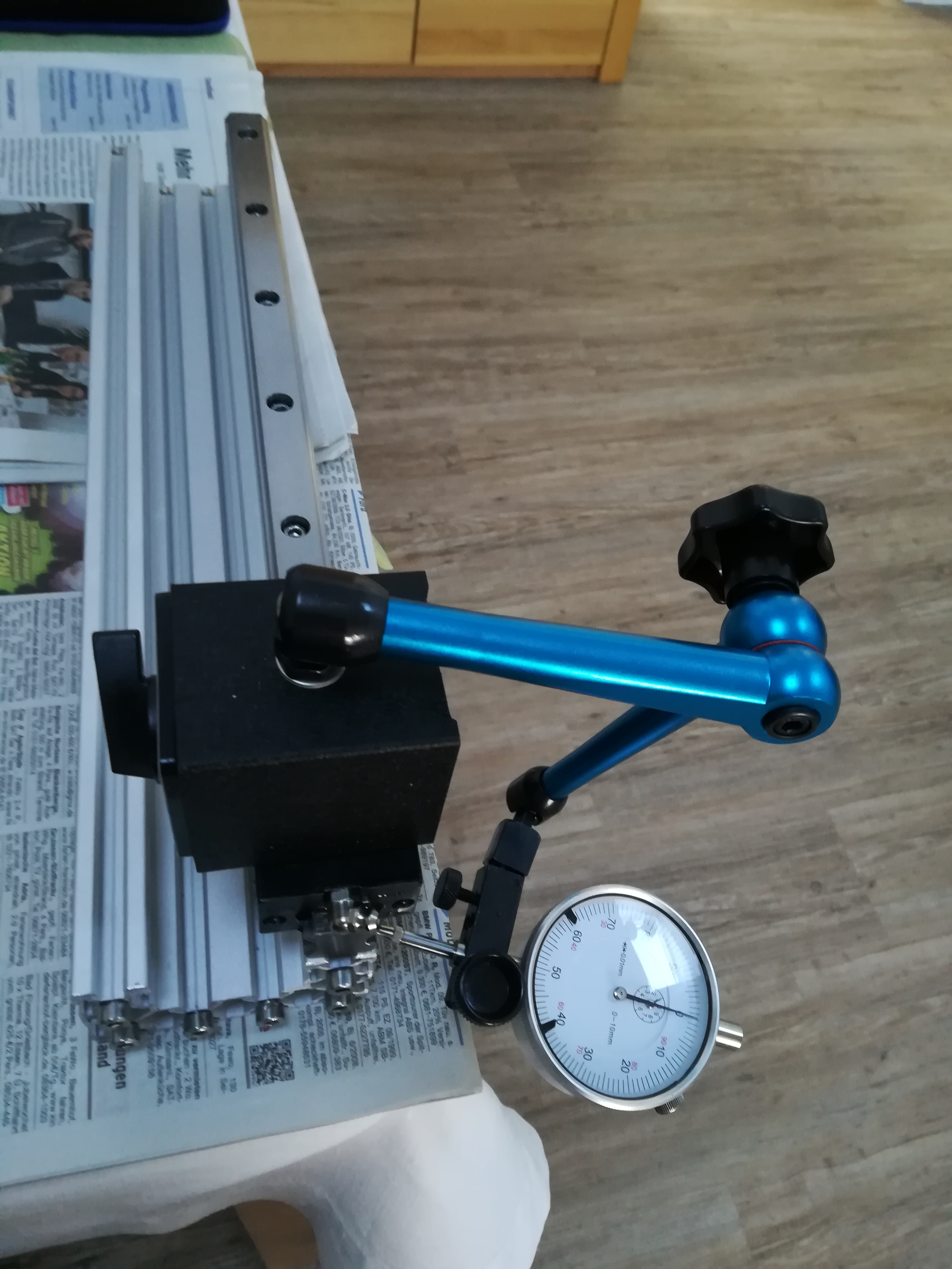

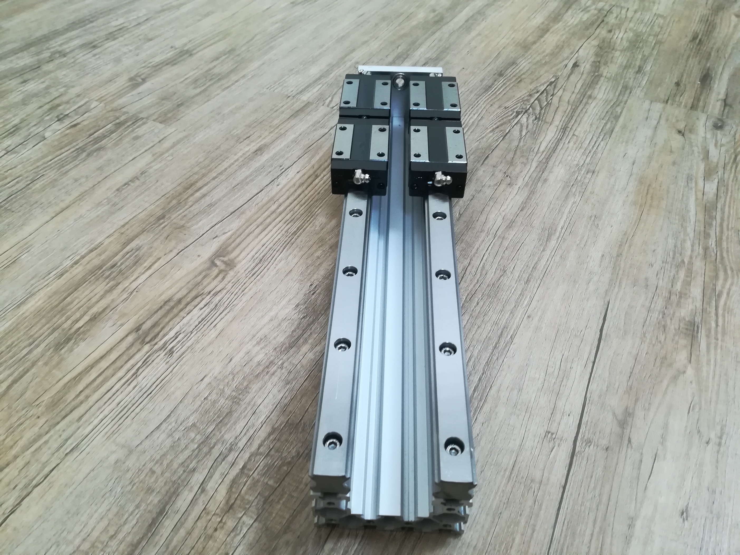

After that I mounted the first linear bearing and made true it’s parallel to the c-beam (on both, top and side):
Then I mounted the second linear bearing and made sure it’s parallel to the other one. I had a difference of max 0.02mm, I guess that’s alright, at least I hope so

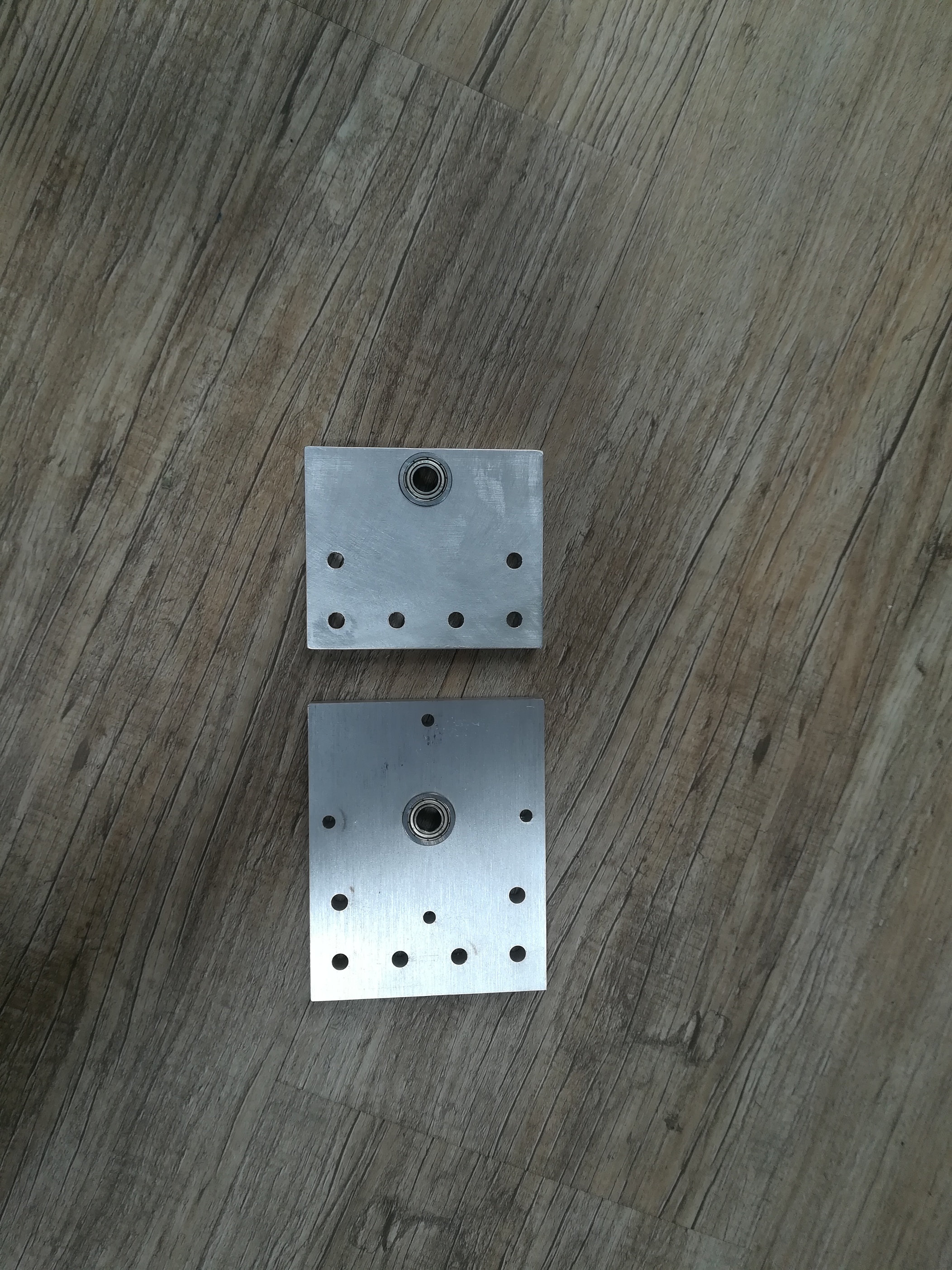

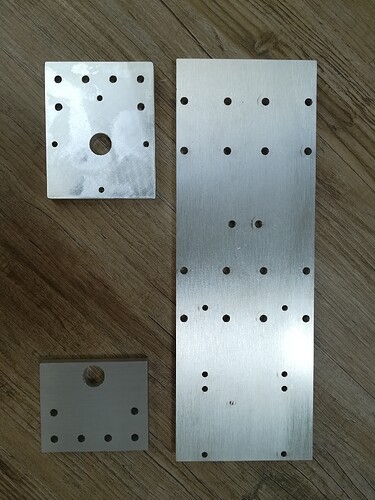

Finally my 10mm thick alumium plates arrived, which I had cut from a german online shop, based on my cad file:
Then I installed the flanged bearings in the end parts and mounted the first one:

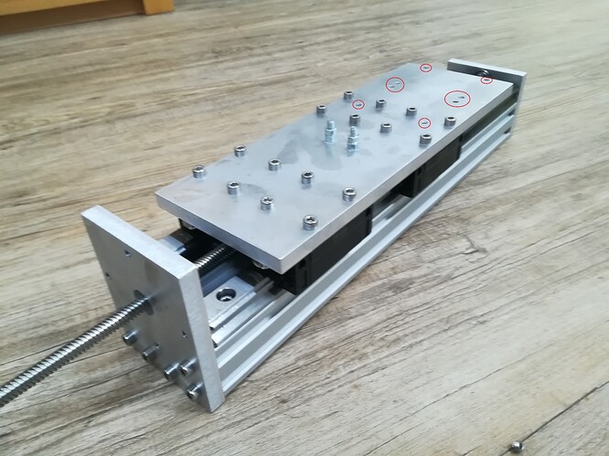

After that the carriages were installed and the second end plate:
Then the front plate was installed (on the inside having a anti backlash nut block):
After that I installed the leadscrew and fixed it using lock collars:
Final picture:
As you can see holes for 2 spindle mounts are already in place. I don’t have a picture of that right now, but will edit my post later.
[Update]
Here’s the picture with spindle mounts installed:
Improvement suggestions are highly welcome, especially if I can implement them in the current design without redoing everything.
My first impression is good. It seems pretty rigid, it moves when the lead screw is turned, everything seems alright. Unfortunately I don’t think the xcarve can handle the weight right now, so I don’t have installed it yet.
