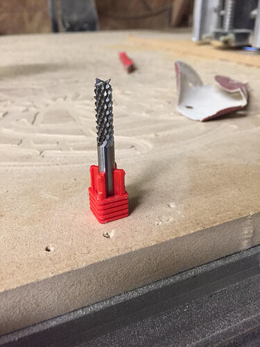

Just got this guy from drillbitsunlimited.com
Lets just say it has cut Dremal sanding almost completely (other than tabs). Gives you very nice edges, say goodbye to fuzzies
For those still using Easel and not able to do climb milling for cleaner edges. Iād get one of these asap.
Search for āchipbreaker bitsā on the site.

If you get a chance, Iād love to see a couple pics of what this bit can do. Are you only using it for profile cuts?

In vcarve, you can get a great edge by using the last pass offset. Iāve been using .01".
Thanks, Phil. Iāll give that a shot this weekend.

Where do i find the option of doing a last pass offset? Iām not seeing anything in my bit details or profile details.
Thanks!
update: found it in the advanced toolpath options haha
I use the last pass offset in Vcarve too but set at .003 with a spiral down cut bit. My profile edges seem to be pretty clean, othan tabs of course
Thanks for the info on doing offset! I liked these bits at first, but they ended up just giving me a bunch of lines on my edges, they came out pretty clean at first, then as the bit dulled they got worse.
Offsetting has worked like a charm!
