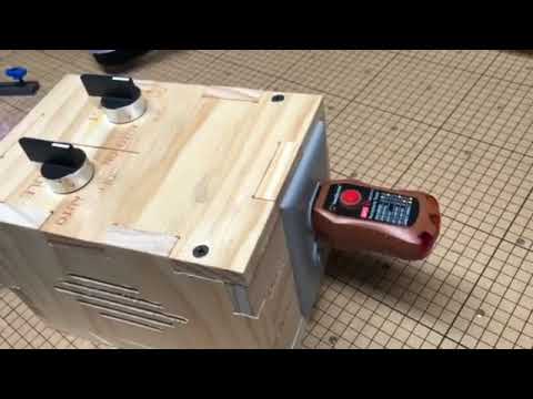

I wanted to share my relay control for the dust collector and the spindle.
I was originally going to go with the IOT relay that adafruit sells, but it was a little expensive and I would need two of them (because my dust collector is a hog and I don’t want it on the same circuit as the spindle/x-controller).
So I decided to build my own.
Materials:
Solid state relays (x2)
https://smile.amazon.com/gp/product/B00PQ7Y8ZU/ref=oh_aui_detailpage_o01_s00?ie=UTF8&psc=1
50 mm fan
8 position terminal board
SPDT 3-postion rotary switch
I already had all of the lugs, wire, cable grips, and an extra outlet sitting around from various projects. I used 20 awg wire for the control signal and 14 awg wire for power.
The build:
I made the box out of 1/2" pine using the box maker app in Easel. I made cutouts for the cable grips, the control switches, the fan, outlet, and some ventilation holes.
I split the outlet by snapping the tie-in clips on the hot and neutral plates. I wired everything per my (poorly drawn) schematic below.
Hope this helps someone get automatic control without spending a ton.
Relay Schematic
EDIT:
I had some bad information and the control signal is not +/- 24v. The relays work just fine, but I need to put the fan on a separate circuit.
Luckily I have a bridge rectifier and some buck converters laying around. Back to work. I’ll update this post and the schematic when I’m done.

Looks good. Just get a heatsink for the second SSR to be safe.
In schematics, a relay is designated by K. In my case I have two relays and they are both actuated by the control signal which then shuts the associated contacts designated by the two parallel lines in my main power circuit.
So when Ka gets power from the X-Controller, it will shut it’s contact and allow the power to pass through to my outlet. I hope that makes sense. I can come up with a block diagram instead of an electrical schematic which may make more sense to people.
The 611 only pulls a couple of amps and won’t heat up the SSR to above room temp. I put a fan in there as overkill.

You should read this regarding SSR’s and inductive loads:
Basically, the spindle and dust collectors are inductive loads. When they turn off, they can release high-voltage spikes. You’ll need something to suppress those spikes, such as a metal-oxide varistor (MOV). SSR’s are vulnerable to events like these.
I built something very similar and it was working just fine for about a month. Eventually, the SSR shorted out. When this happens, they tend to stay in the closed position… it also started sparking and lit up bright orange.
Next time I have to work on my electronics I’m going to use one of these contactors.
Note: this one uses a 24 volt activation coil. There are others with different activation characteristics.
@TreyBillings
Great article! The overall load of the circuitry puts me well below the ratings of the SSRs, so I feel confident that everything is ok.
I have entertained the idea of a metal enclosure just to bring things a little closer to a NEMA standard. Right now, if something were to go wrong, I have made myself a tinder box. So it looks like my next project involves some metal fabricobbling.
I did a little bit more searching around and figured that I would need an MOV with thermal protection. When the MOV goes bad, it goes bad in flames.
Mouser electronics has a good selection.
@LarryM
I was leaning away from the mechanical relays and contractors. Since these are being used in an environment with plenty of sawdust, I didn’t want any arcs. I have a filter screen on my box, so that should help, but SSRs were my preferred method.
@RobertCanning
I read a few articles on faux foteks and found some alarming issues. The most common issue is their party distributors will buy lower rated foteks and slap a higher rating sticker on them.
When I remake my control box, I’ll probably spend the extra money and get the crydoms. The peace of mind will be worth it. Plus some models have the MOV and thermal fuse built right in.
