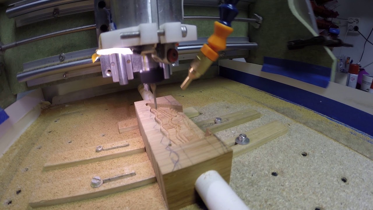

Work in progress, making a new control stick to my plane. I am new to organic modelling and struggle a little with F360 so this is good excersise. The electronics shown in earlier post will be housed by a separate part which will be glued to this stick grip. Hence the angled top.
First image show the modelled shape with finger grips plus a border outlined for containing the area of carve.
26168994_10155452698427217_8739701895539731844_n
This image show the raw stock (bamboo) being carved, due to overall depth of cut (21mm) I only had one end mill that could reach so I went conservative on the feed & speeds. 3mm 2F used. First side being carved.
26168143_10155452694577217_5620398862692050400_n
